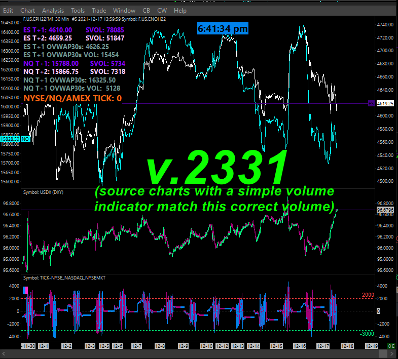

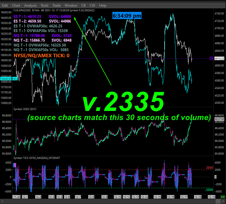

[2021-12-19 02:21:08]
Using SC Since 2020 - Posts: 150
I look at the last 30 seconds of volume for each day. I simply have a chart setting time for 3:59:30 to 3:59:59 (EST). I use a volume study (basic).
To determine settlement, I use a VWAP study of that 30 seconds.
Because of the volume difference between the versions, the settlement prices were off and so was volume.
Again, absolutely no changes were made to Sierra Chart except updating to the 2335 pre-release. Rolling back to 2331 immediately fixes the volume discrepancies.
I just updated to prelease v. 2335, and the issue comes back. Rolling back to version 2331 (again), fixes the volume issue. Quite strange.
See attached files labeled for their version. Volumes in v.2331 are accurate, whereas 2335 are grossly inaccurate. I compared all potential volume settings between the two versions with a fine tooth comb, without finding any differences whatsoever (again, there is a control here, which is that I made no changes to Sierra Chart after changing to their most recent version). Also, I had a user who had accurate volume, send me their chartbook from an earlier than 2335 version (2333) and in version 2335, that chartbook still produced inaccurate volume, while in their version of SC, it produced accurate volume.
Also, I asked an additional Sierra Chart user to update to v.2335, and they had the exact same issue. I'm sure they'll be posting shortly.
In the attachments, "ES T+1: xxxx.xx" uses VWAP of the 30 seconds volume, and "SVOL: xxxxx" is the volume of that 30 seconds. SVOL = Settlement Volume. Perhaps users who eventually point out the discrepancies (they're coming, I'm sure of it) can compare to the volumes, thus why I provide an explanation of the screenshot grabs of that info-chart.
Date Time Of Last Edit: 2021-12-19 03:04:15
imagev.2335.png / V - Attached On 2021-12-19 02:40:44 UTC - Size: 75.27 KB - 295 views
imagev.2331.png / V - Attached On 2021-12-19 02:43:19 UTC - Size: 78.52 KB - 274 views

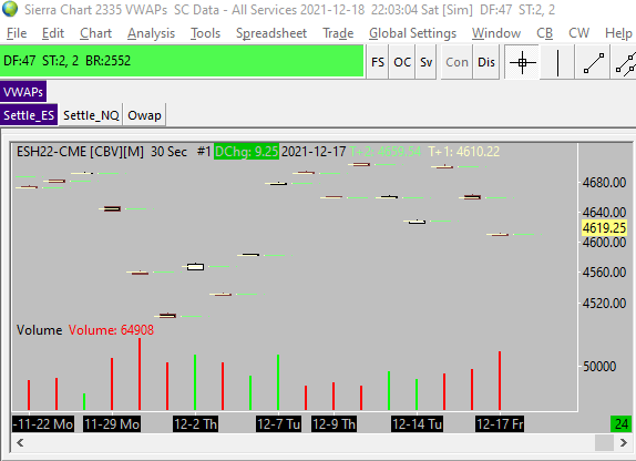

[2021-12-19 03:05:46]
thatAmaze - Posts: 1
I also track the last 30s /ES closing volume. Upon updating to v.2335, I also observed the same as Trade Your Plan described.
Please see attached screenshot.
The intraday calculated volume for ESH22 for 2021-12-17 at 15:59:30 to 15:59:59.999 US Eastern standard Time is: 64908.
Thanks for looking into this.
imageSC2335.PNG / V - Attached On 2021-12-19 03:04:04 UTC - Size: 20.48 KB - 343 views

[2021-12-19 06:04:23]
Any chance SC has tested these two versions for the stated date/time in the prior post and show consistent volume between versions?
Yes the volume is consistent as shown here:
https://www.sierrachart.com/image.php?Image=1639892381958.png
Same volume as 2330.
We tried then adjusting the session times to just 30 seconds and we do see the problem. It is not a volume issue but it is a time comparison issue which is apparently preventing the last second of Intraday data records from getting included in the bar, which ends at the session end time. So this only affects that one particular bar. It relates to supporting milliseconds time periods for chart bars.
We will get this resolved.
