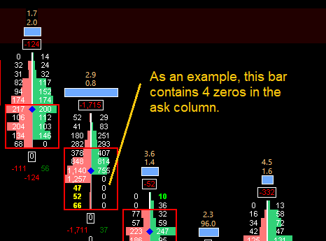

Assuming the following:
>> Charting ES using 2.5R bar (i.e., 11 ticks/bar)
Is there an elegant way for me to obtain a count of how many bid-at-price slots within that bar were zero?
Something similar to this, but perhaps allowing a range to be specified:
COUNTBLANK(BVAP(H-TICKSIZE),BVAP(H-TICKSIZE*2),...,BVAP(H-TICKSIZE*11))
I'm not even sure if COUNTBLANK will count a "0" volume value as blank, but assuming it does, my problem is that using the above very lengthy calculation as part of a CBBOAC formula is extremely cumbersome, especially when the expression needs to appear multiple times within the formula.
Is there something more abbreviated I can use to specify the price range slots that constitute a bar, or (in the alternative) to simply count the number of zeros that occur in a price bar bid/ask column?
I attached an example using a 3rd party study, but I could just as easily have used your Numbers Bar study to illustrate the same example.
Thank you!

[2021-12-20 15:16:02]
John - SC Support - Posts: 48028
There is a way to do this, although it is a bit outside of the typical use case.
Use the Volume At Price Threshold Alert V2 study and set the following Inputs:
- Comparison Method: Ask Volume Bid Volume Ratio
- Percentage Threshold: 1000 (for the Bids, use -1000 for the Asks)
- Enable Zero Bid/Ask Compares: Yes
- Zero Value Compare Action: Set Percentage to +/- 1000%
Subgraph 59 then has a "Count of Alerts" that you can use to get the number of 0 Bids.
The one thing to be aware of is that you will get a few additional comparisons in the mix where the ratio is larger than 1000%, such as an Ask of 12 and a Bid of 1 (1200% ratio).
