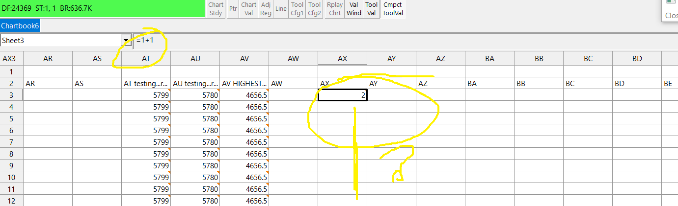

seeing something ive never seen before... i have a spread sheet study attached to a 5 min chart
ive been using this sheet for some time now and havent changed any settings since i attached it
i attempted to enter a formula in a column at row 3. it accepts the formula as usual however, it doesnt populate the colunm below row 3
when I select 'RECALUATE ALL FORMULAS', the formula i added to row 3 is cleared.
I attempted to attach a picture...dont know if it sent.
any assistance appreciated
imageScreenshot (6).png / V - Attached On 2021-12-17 21:21:58 UTC - Size: 35.8 KB - 303 views

The first issue is that the column you are entering data into is not a "Formula Column", therefore it does not populate down like the columns K-Z (by default) will do. There is an Input for Number of Formula Columns.
The second issue we can not reproduce. Our formula stays in the cell. If you are putting a formula into a cell in that column for a reason, then try moving to a column further away from the Study Subgraph data columns. See if that will resolve the deleting issue.

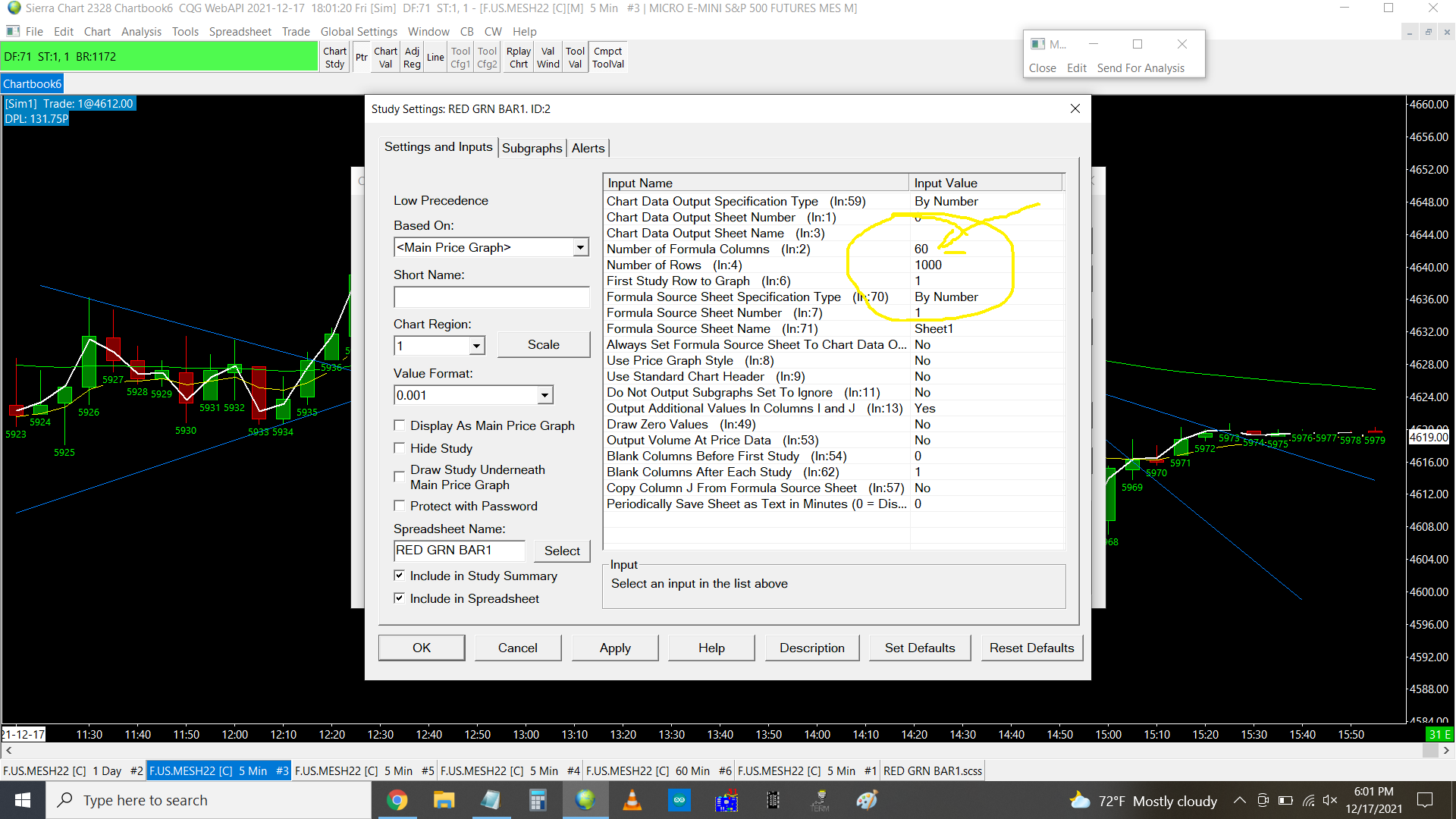

[2021-12-18 00:00:25]
User183724 - Posts: 194
I have the spread sheet set to 60 columns in the study settings and it was working fine until today
[2021-12-18 00:03:23]
pic
imageScreenshot (7).png / V - Attached On 2021-12-18 00:03:13 UTC - Size: 234.56 KB - 253 views
