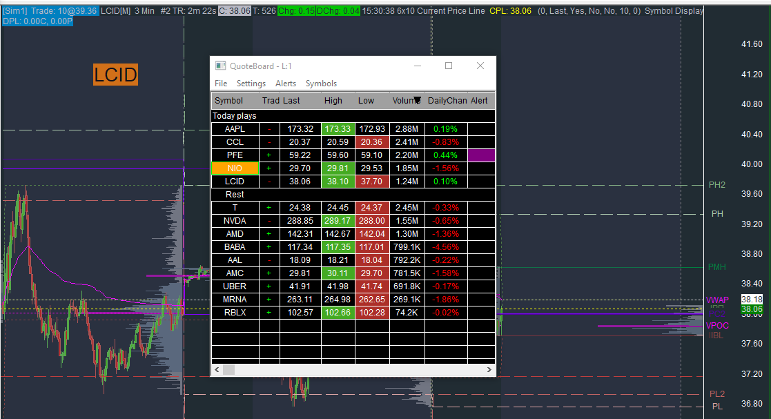

[2021-12-22 18:40:04]
MalyKubo - Posts: 15
Hey John
Regarding quoteboard issue Im having.
I was able to make a screenshots during today's session open. Maybe it will help you to replicate it.
So before open I switched to LCID which was on 4th place on quoteboard (5th if we want to count label on first row)
After open there was shift in volume and because Im sorting symbols in quoteboard from highest volume to lowest, LCID jumped to 5th place (6th with label)
I did not click anywhere, but you can see that highlighted position in quoteboard stayed at 4th place which is now NIO
Hopefully this can help
imageLCIDHighlighted.png / V - Attached On 2021-12-22 18:39:53 UTC - Size: 67.62 KB - 329 views
imageNIOHighlighted.png / V - Attached On 2021-12-22 18:39:58 UTC - Size: 75.71 KB - 280 views
[2021-12-22 23:54:33]
Regarding post #8, that is just how the functionality works when sorting.
[2021-12-23 06:39:19]
Oh so it is wanted behavior.
I would like to ask then if it would be possible to add highlighting functionality, where symbol would stay highlighted during sorting?
Thank you
[2021-12-23 14:49:32]
No, this will not be supported.
