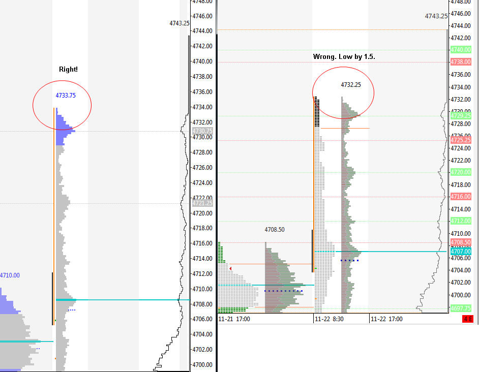

I had to adjust for rollover last Thursday.
(Always have to for some reason)
I have one chart that is off by 1.5 points. All the
other ones match.
How do I adjust just one chart?
PS I know how under Global/Symbols for all of them.
image1mmmm.jpg / V - Attached On 2021-12-16 19:34:42 UTC - Size: 110.99 KB - 259 views

Do you have multiple charts with the same symbol using the Continuous Futures Contract and there is one chart among those, that is not showing the correct back-adjustment?
The only thing we can think is that this particular chart is using a different back-adjustment type than your other charts. Make sure they are all using the same option. Refer to the following:
Chart Settings: Continuous Contract (Chart >> Chart Settings >> Symbol >> Symbol menu)
