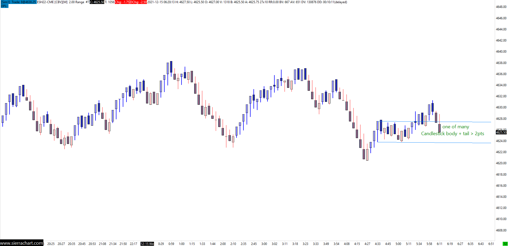

I am plotting ES-MINI March 22 futures contract with Candlestick Bars
Tick size .25
Using Range Per Bar - Standard (in ticks), Settings to 8.
Yet many of my candlestick bars (including tail) are more than 2 points range?
Not sure how to fix this.
Footprint - works fine with this setting which is identical
Please help
Stephen

It is not possible that on the same chart the Numbers Bars are showing the correct range but the candlesticks are not.
Please get us an image of what you are seeing so we can understand better what is occurring. Refer to the following for how to take a screenshot:
[2021-12-15 11:33:07]
Stav - Posts: 104
https://www.sierrachart.com/image.php?Image=163956782883.png
Stephen

[2021-12-16 17:08:23]
John - SC Support - Posts: 48239
What you are seeing is not correct. You have the Heikin-Ashi study on the chart, which is obscuring the actual High and Low for the bars and showing . If you hide the Heikin-Ashi study you will see the actual bars all have a correct range.

[2021-12-16 22:49:11]
Stav - Posts: 104
I have chosen candlesticks in both chart setting and in studies for the ES-Mini? Where does it say I am using Heikin-Ashi?
So not sure what you're saying?

[2021-12-17 15:06:51]
The chart you gave us has a Heikin-Ashi study on it. Go to Analysis >> Studies and remove that Heikin-Ashi study.

[2021-12-17 15:58:26]
Stav - Posts: 104
Hi John,
Strange I have deleted the graph and now I have a graph which is in range!
Thanks for your help, I'm just trying to get to grips with the software, so thank you for your time.
