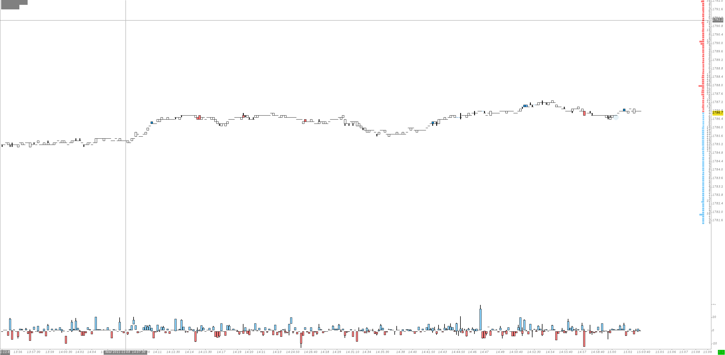

On the Market Depth Historical Graph set the Input for Show Quantity Numbers to In Bars and After Last Bar and then ensure that the coloring for the Bid and Ask Depth Quantities is a color that can easily be seen against your background. Take a screenshot of what you see and post it here using these instructions: Support Board Posting Information: Attaching or Posting a Screenshot/Image (Optional) For the most reliable, advanced, and zero cost futures order routing, use the Teton service: Sierra Chart Teton Futures Order Routing |
| [2021-12-08 20:10:49] |
| User117347 - Posts: 48 |
Show quantity numbers: Did this and numbers do not show Color: I adjusted for color, the depth did not appear. Screenshot: There is no market depth loading on the chart https://www.sierrachart.com/image.php?Image=1638993817350.png |

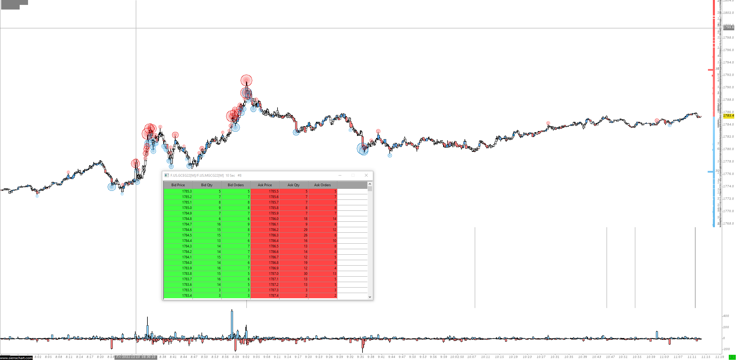

Please do the following for us on your GC chart: - Open the Market Depth window by selecting File >> Open Market Depth Window. - Select Edit >> Screen Images >> Upload Chart with Overlays - Wait about 5 seconds and you will get a pop-up window that states that the image has been uploaded and pressing OK will put the link to the image on your clipboard. Click OK on that window and then paste the link into this posting and post it for us so we can see your Market Depth window. For the most reliable, advanced, and zero cost futures order routing, use the Teton service: Sierra Chart Teton Futures Order Routing |
| [2021-12-10 16:14:16] |
https://www.sierrachart.com/image.php?Image=1639152813898.png
| [2021-12-10 18:12:23] |
| John - SC Support - Posts: 48658 |
The good news is that you are getting the market depth data, so that is not the issue. We want to take a look at that chart. Follow these instructions to get us the chart: Support Board Posting Information: Providing Chartbook with Only a Single Chart For the most reliable, advanced, and zero cost futures order routing, use the Teton service: Sierra Chart Teton Futures Order Routing |
