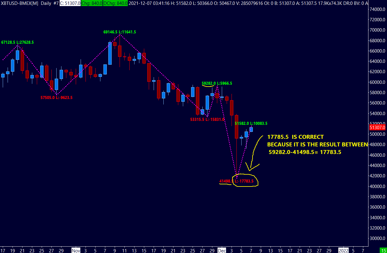

I'm experiencing an issue on the Zig Zag on calculating mode 1 (% calculation)
I made a control and it seems to me that the calculation is WRONG.
ON THE ZIG ZAG INDICATOR
I've setted Calc mode 1 to show me rotation larger than 10% and that's ok
If i put the "Display Lenght of ZigZag" in Point it calculates correctly as you can see the calculation is correct (the difference from the extremes of the ZigZag length)

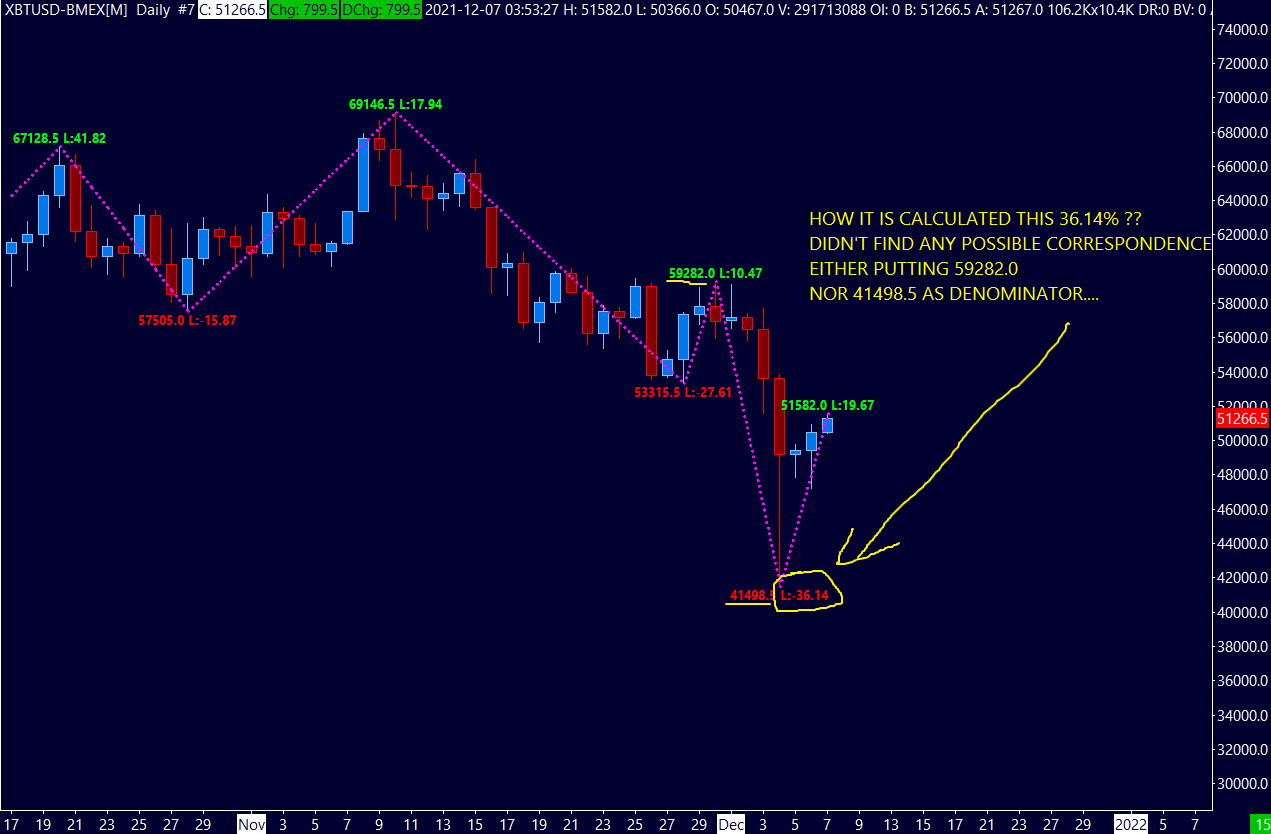

But if I put in the "Display Lenght of ZigZag" in Percentages this calculation in my opinion is wrong as you can see from the images.
Could you please explain for example how it is calculated 36.14% ?
To have a correct and useful number it should be 17783.5/59282.0*100=29.998% (in this rotation mkt has fell 29.99% from the extreme of the Zig Zag line)

imageZig Zag showed in points CORRECT.jpg / V - Attached On 2021-12-07 10:00:29 UTC - Size: 376.77 KB - 448 views
imageZigZag -showed in percentages INCORRECT.jpg / V - Attached On 2021-12-07 10:05:02 UTC - Size: 424.21 KB - 322 views

User907968 - Posts: 883
Zig Zag
Percent: This displays the length of the Zig Zag line as a percent difference using the most recent value as the denominator.
Most recent price = close = ~49000
17783.5 / 49000 * 100 = 36.29%
