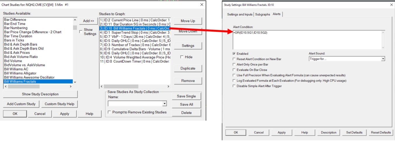

[2021-12-14 09:55:27]
Peter Beil - Posts: 19
Thanks John - tried exactly this (see settings attached) but it doesn't work. Any further idea what to do?
image2021 12 14 Alert Issue.jpg / V - Attached On 2021-12-14 09:55:02 UTC - Size: 266.3 KB - 362 views
[2021-12-14 16:04:46]
Sorry, it was pointed out that the Bill Williams Fractal actually does not check the current bar, rather it looks at the previous 4 bars. Therefore, you would have to put the following formula to alert then the signal occurs:
=OR(ID10.SG1[-1], ID10.SG2[-1], ID10.SG1[-2], ID10.SG2[-2], ID10.SG1[-3], ID10.SG2[-3], ID10.SG1[-4], ID10.SG2[-4])
