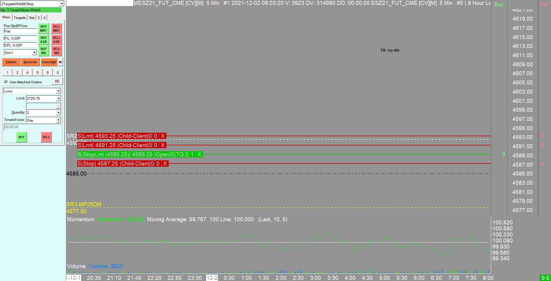

I am using version 2328 64 bit. When I move my limit order in SIM my scales and stops do not move as they should. Then I switch to live and I move my limit order, and it moves my scales and stops as it should.

Sorry, but we are not able to understand exactly what you are seeing from your images. Can you please give us some more information on exactly what is occurring when you are in Sim mode that is not happening when in live.

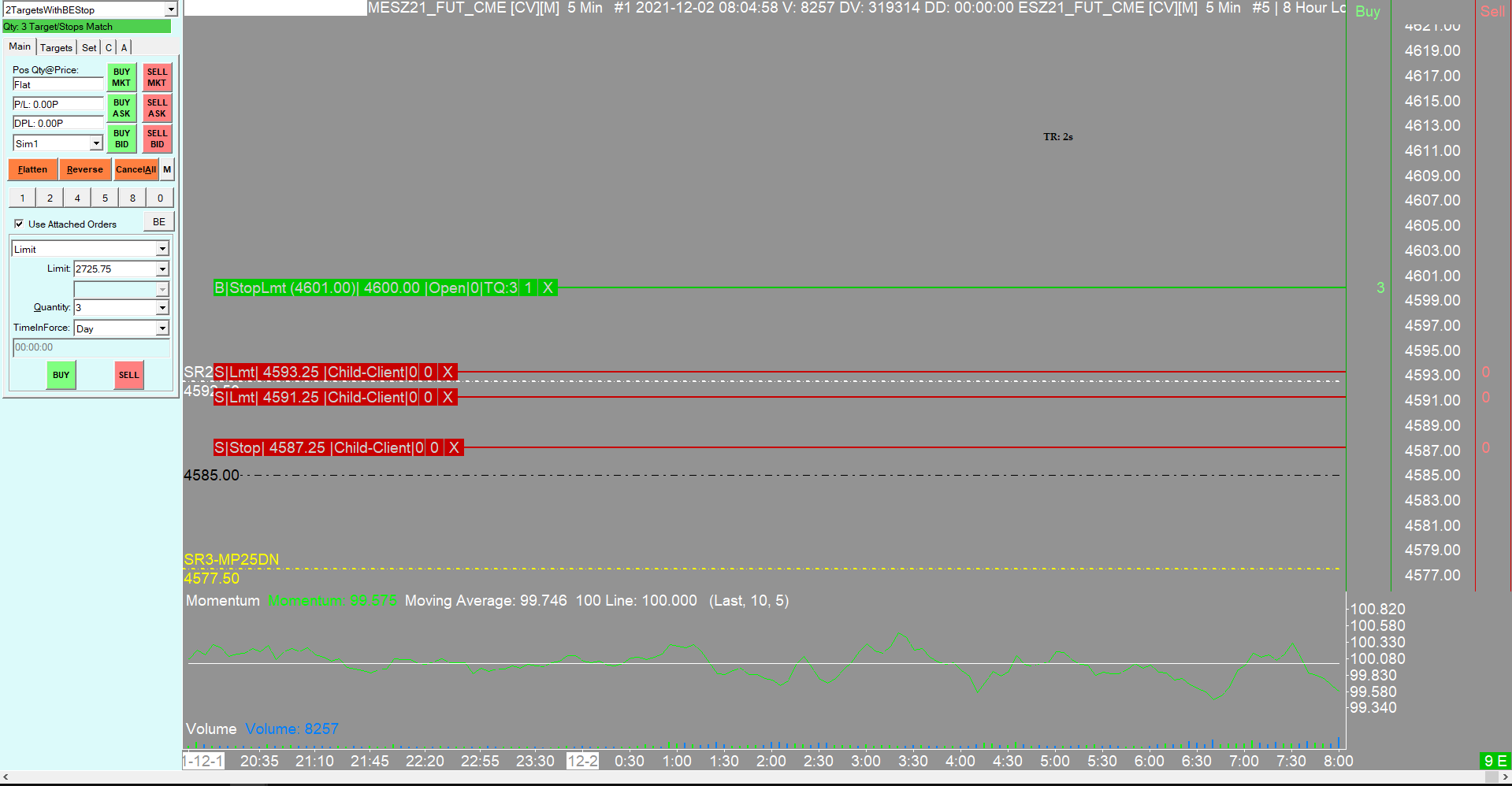

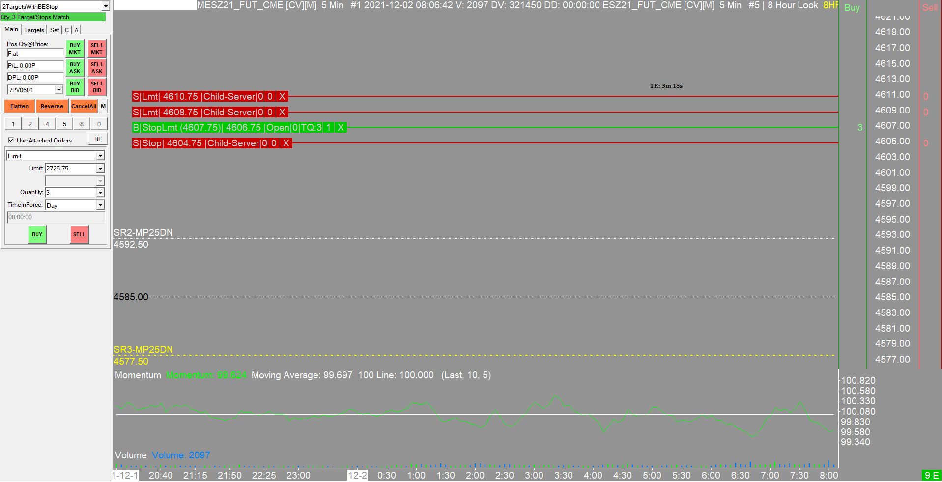

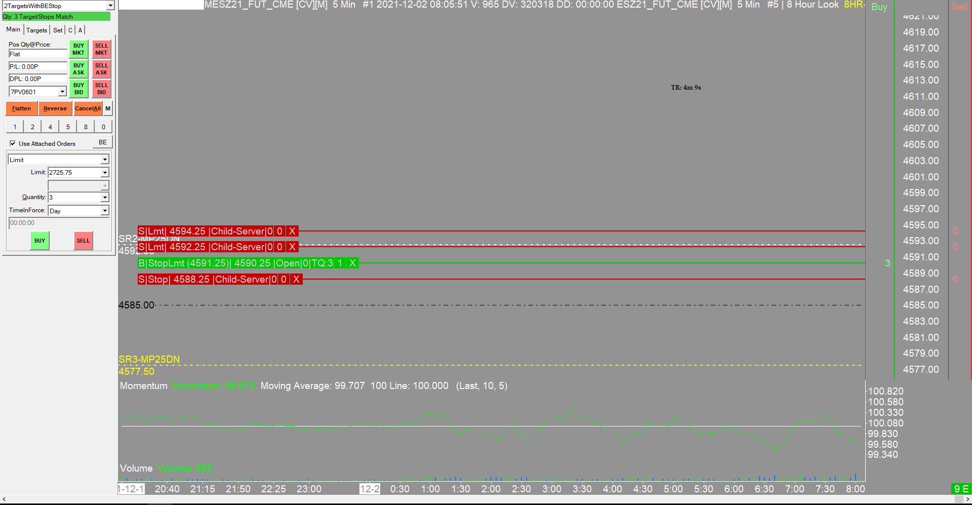

In the DOM1 pic is SIM when I move the limit order, the remainders and stops should move as one group, but they don't. If you look in DOM2 pic, you see that only the limit order moved. Dom3 and DOM4 pic shows that I was able to move the limit order and everything moved as one group
