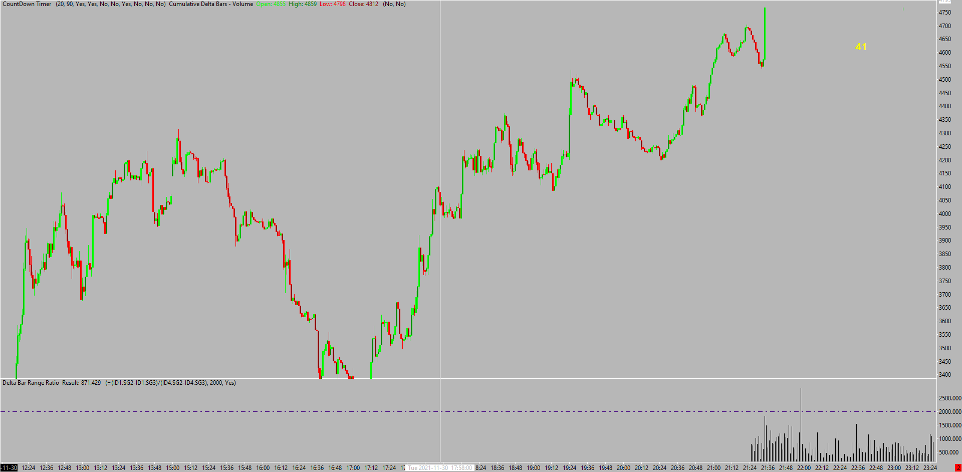

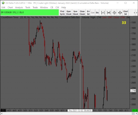

[2021-12-02 14:46:46]
ssangha84 - Posts: 132
Ok I have an example from today. On the two charts, where the lines are are the exact same spot. But look how completely different they look. On their delta chart, it basically made a double top, but on mine, the delta is way lower. And if you look previous to that, the highs on their chart made a lower high, on mine it made a higher high. You can just see that these two charts are completely different. And also if you look at the values on the right, those are completely different as well. Again, all of the settings are completely the same. And the brokers and data feed is the same as well. So no clue why this would be happening.
imageKDelta.jpg / V - Attached On 2021-12-02 14:45:59 UTC - Size: 45.12 KB - 315 views
imageSDelta.png / V - Attached On 2021-12-02 14:46:07 UTC - Size: 62.75 KB - 323 views

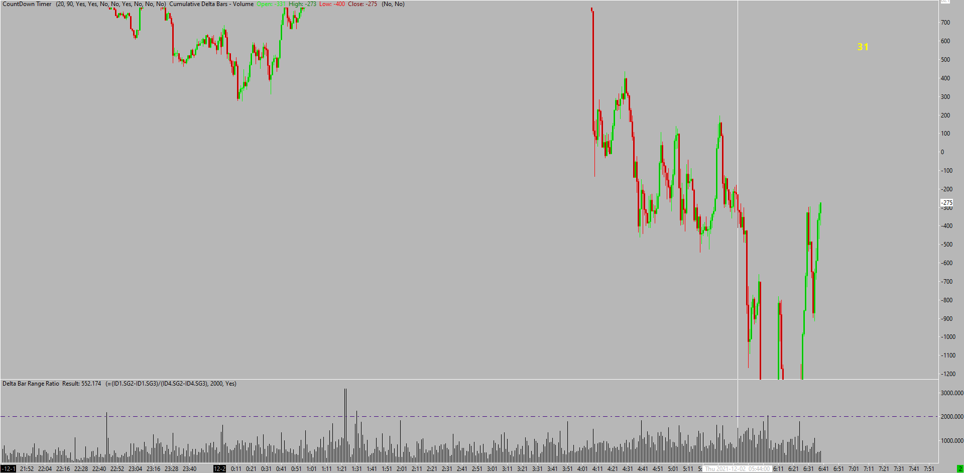

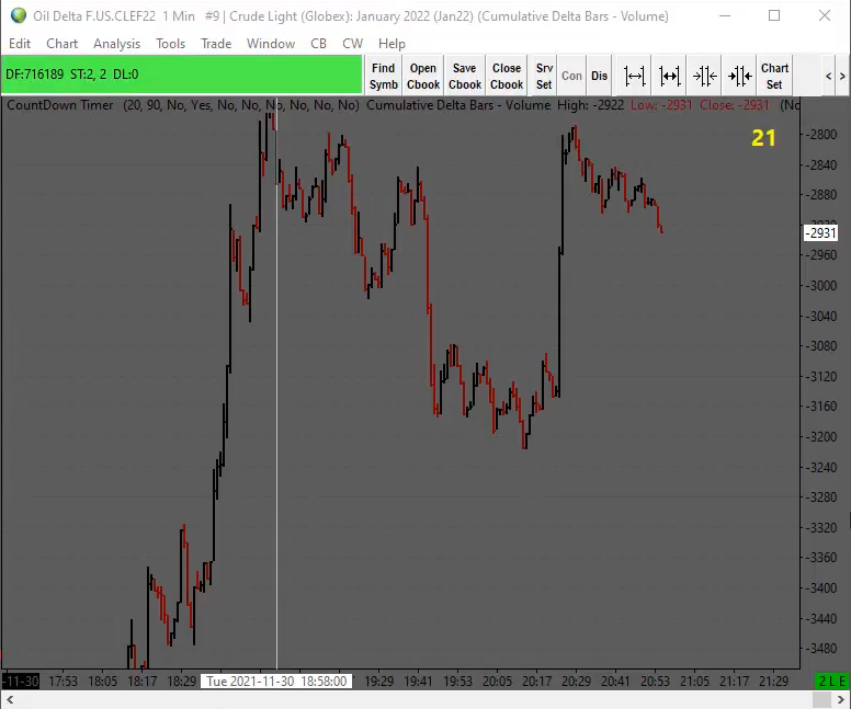

[2021-12-02 15:50:12]
Another example from Tuesday. Again, the lines on each chart are at the exact same time. These two charts look completely different after the lines.
imageKDelta2.png / V - Attached On 2021-12-02 15:49:16 UTC - Size: 222.29 KB - 331 views
imageSDelta2.png / V - Attached On 2021-12-02 15:49:23 UTC - Size: 64.15 KB - 338 views

[2021-12-02 18:29:34]
The first thing to figure out is why you are seeing very different values in the scale. One is at -2931 while the other is ~4000. There is something in the setup that is different and you would need to figure out what that is.
One item in particular to check is Chart >> Chart Settings >> Advanced Settings 3 >> Combine Trades Into Original Summary Trade, as this could be an item that is easily overlooked. But you need to ensure that the Session Times are the same, and whether the charts are resetting or not at the beginning of a session, etc.
