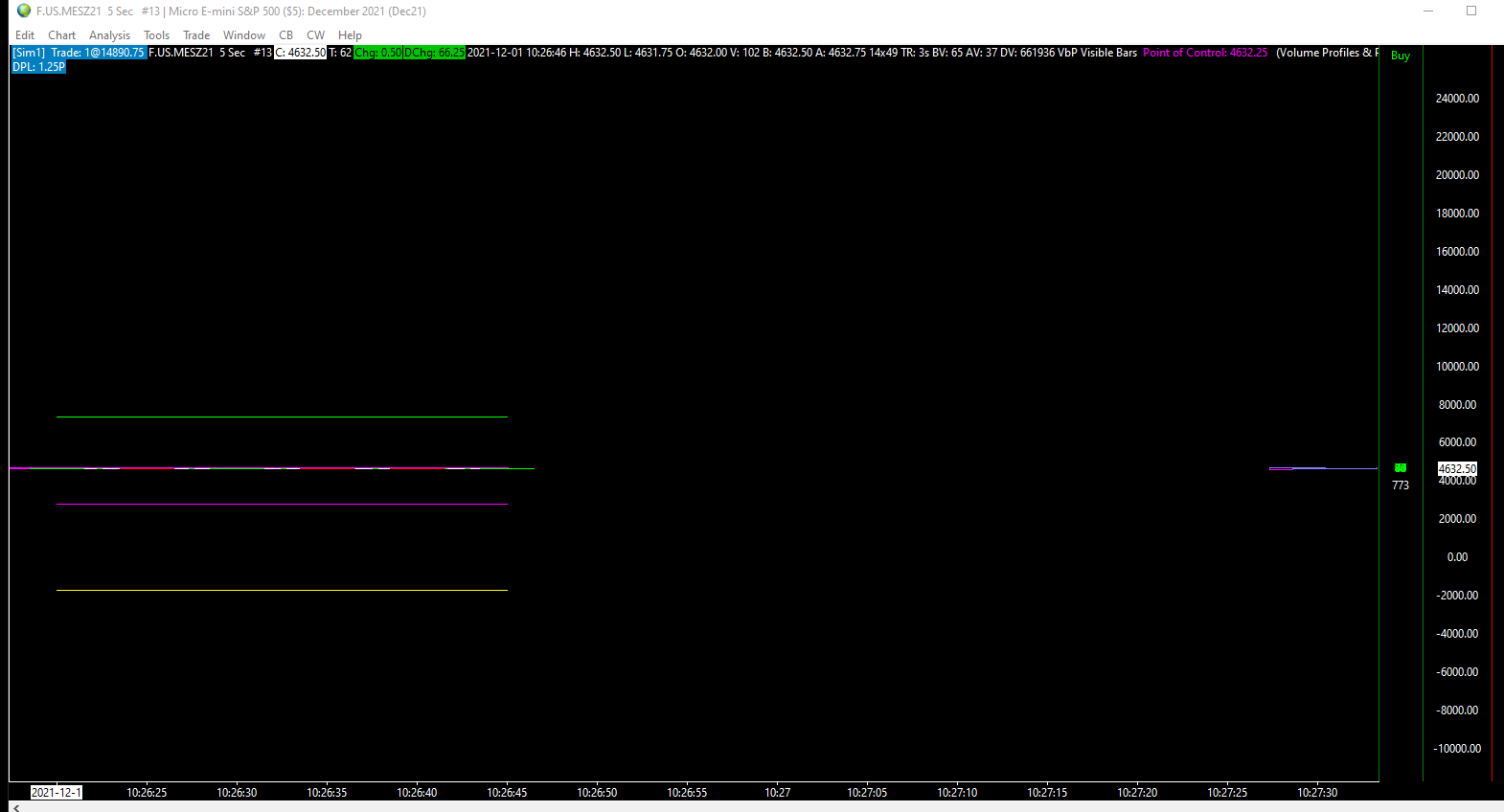

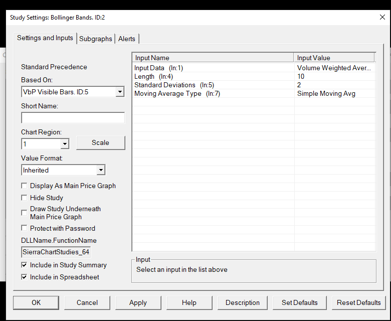

did the BB suggestions, getting similar results - the bars and VWAP are squished together, notice the price values on y axis are crazy. the top and bottom BB lines are above and below the VWAP, but the center BB lines is way below.
I have attached pics one is how the display looks after I apply the studies the second is how I setup the BB study

The problem is that when you are putting that study on a VbP that is set to display just "Visible Bars", then if there are not many bars visible, your VWAP will not be correct, or may not be calculated at all, in which case the Bollinger Bands are going to be based on bad data, which is why you are getting bad results.
You really just need to use this functionality when you have a specific timeframe for the VbP.
