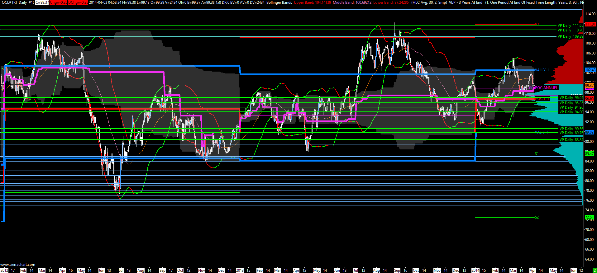

Hello as you can see on the chart, there is problem with daily chart.
Data provider is IQfeed, the IQfeed support told me that the problem was from your side..
Can you help me please
http://www.sierrachart.com/image.php?l=1396454173256.png
[2014-04-02 16:45:30]
Please describe what the problem is.
We think we know what you are referring to. However, this only demonstrates two basic things:
You are not understanding how futures contracts work.
And IQ Feed either did not understand the problem, and also does not understand how the futures contracts work.

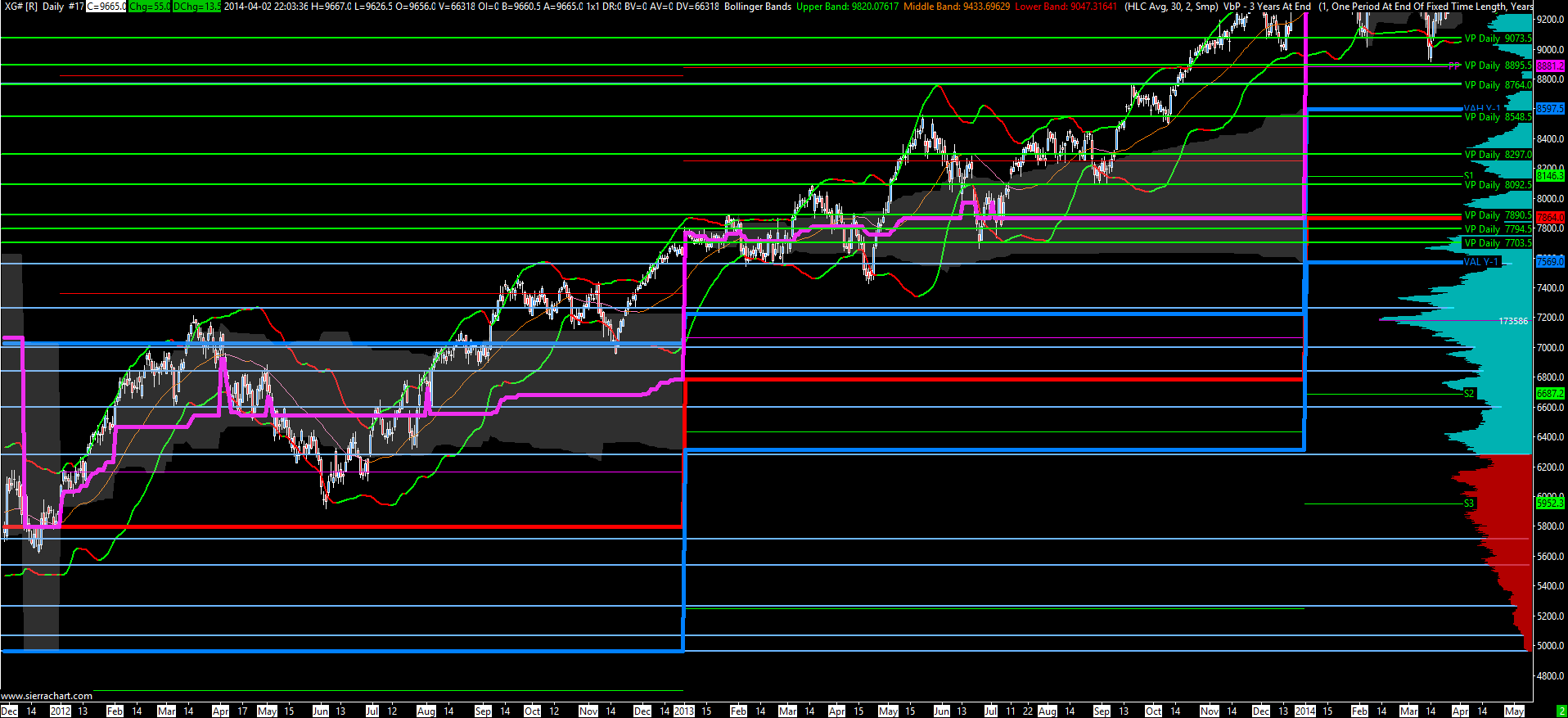

TradingMarketProfile - Posts: 120
this is DAX : http://www.sierrachart.com/image.php?l=1396493841138.png
this is YM : http://www.sierrachart.com/image.php?l=1396493895196.png
this is Crude : http://www.sierrachart.com/image.php?l=1396493943837.png

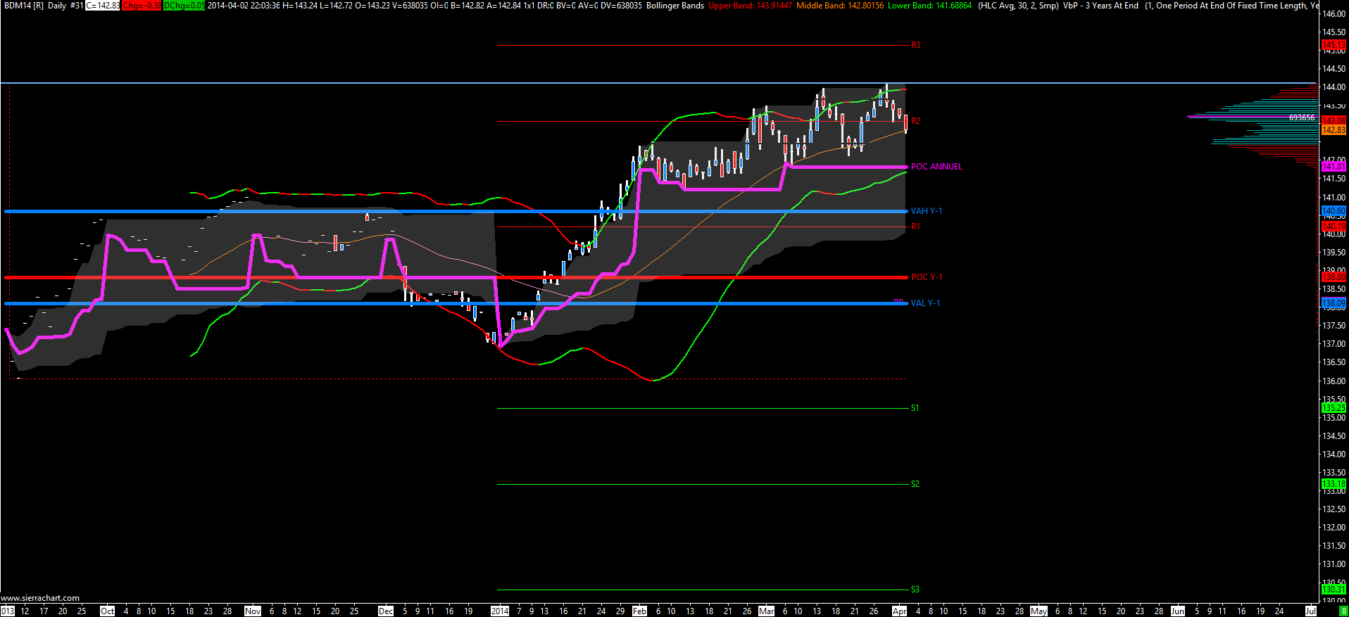

And this is Bund : http://www.sierrachart.com/image.php?l=1396493971207.png
There is only problem with the Bund so i would like to understand what is the problem
I don't know if the problem is IQfeed side or your side, the thing is i would like to get that chart like the other
[2014-04-03 04:29:16]
We see these images, but what is the difference between the symbols of the charts? For the Bund, it is not a continuous contract symbol. But for the others, they are.
We are only trying to help you realize what it is you are looking at and how the IQ Feed symbols work.
Even if a particular IQ Feed symbol is not listed in File >> Find Symbol, it can still be manually typed in.
We have added BD#. This is a continuous futures contract symbol.
