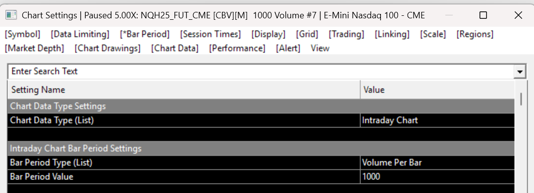

By the way, this is where I'm at now - four different trade signals (Buy/Sell Entry, Buy/Sell Exit), displayed as ACS drawings at the price point where they occurred. The drawings provided by the SC spreadsheet studies are fantastic, but I found that having the drawings at either the top or bottom of a chart bar was not granular enough for my trading style--hence my delightful recent descent into the world of ACSIL and C++.
The key issue was controlling the rapid growth in the number of ACS drawings on the chart and the subsequent slow down in the chart (just like the SC documentation warns about). That's where a persistent double-ended queue came in. The attached GIF shows the 20 most recent trade signals being kept, while anything older gets deleted--the chart stays nice and responsive. For debugging, I used good ol' "print statements" to monitor variables, writing to the SC Message Log via sc.AddMessageToLog(). For context, this was from yesterday's NQ action, viewed on a 1k Volume chart.
I have some other ideas that I'll tinker with (e.g. add the ability to persist a certain number of drawings on each bar, to preserve some "visual memory" of the trade signals while still keeping the overall number of drawings under control), but the big hurdle for this idea has been cleared. The next major effort will be creating an ACSIL trade system so that I can back-test my criteria properly. I've done a lot of this via the awesome SC Spreadsheet System/Alert for Trading; now I get to throw some ACSIL at it :)
