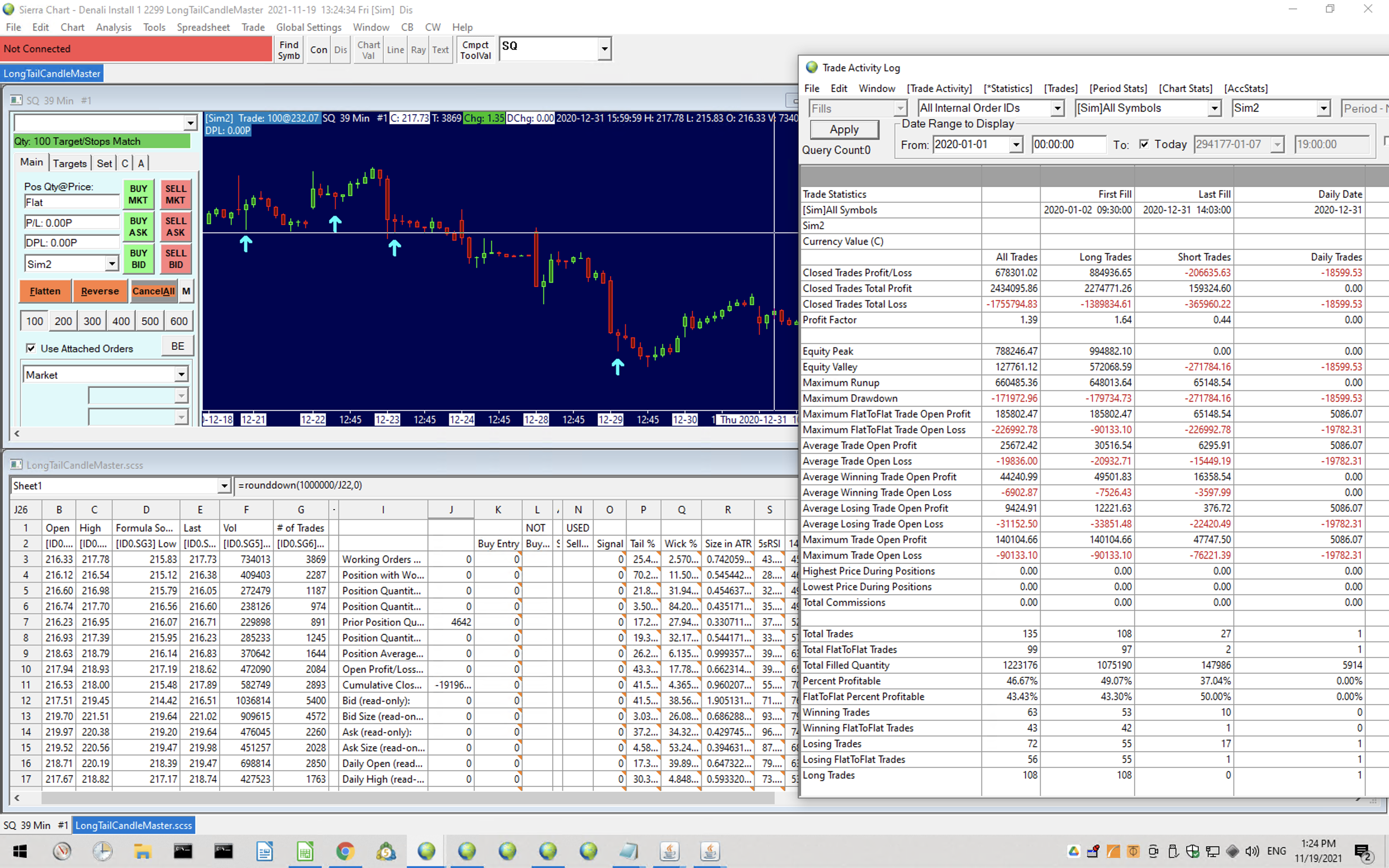

I have a long-only strategy I have been putting together as a spreadsheet system.
Column K is the only one used - LM and N are all empty - exits are based on bracket orders.
When I run a scan based backtest (7 stocks), I am getting several Short trade results!
I can't even think how this would happen to start to troubleshoot it?
I seem to get different results every time I run it too - maybe something is corrupted?
I have restarted the application...
It seems to relate to big gaps taking the price over the buy stop entry, but surely a Buy Stop order will never be sent as a Sell Stop even if it has gapped over the entry price before the order gets placed?
Has anyone seen this before? - screenshot attached (note backtesting results with numerous Shorts despite empty column LM and N!)...
I think something is thoroughly corrupted in fact - this has been working fine to date.
Maybe suggestions on how to reset SC? - I did a restart, and cleared all trade sim data.

imageScreenshot 2021-11-19 at 18.24.36.png / V - Attached On 2021-11-19 18:27:44 UTC - Size: 3.24 MB - 292 views
