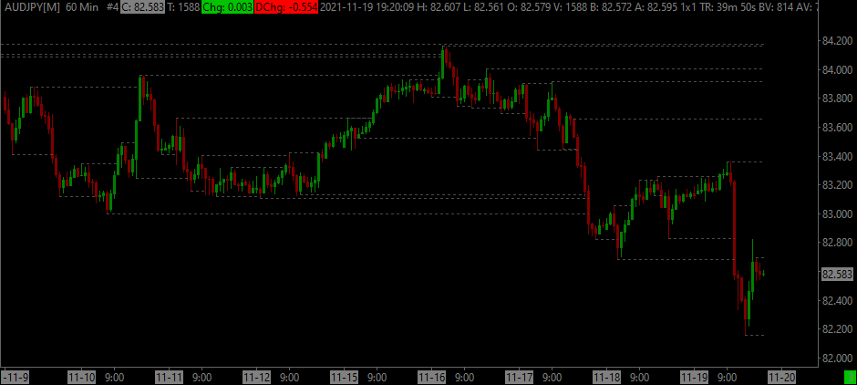

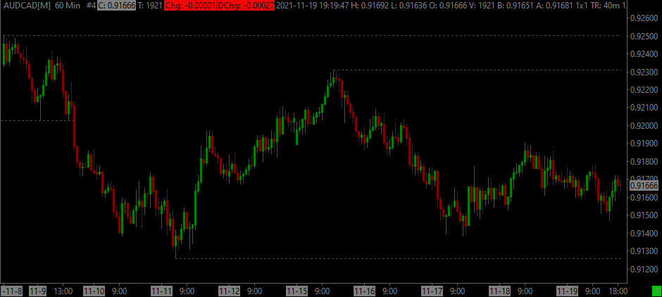

Works on : CADJPY, AUDJPY, EURJPY, NZDJPY ...
Don't work : AUDCAD, AUDNZD, AUDUSD, EURCAD ...
imageAUDCAD[M] 60 Min #4 2021-11-19 19_19_48.343.png / V - Attached On 2021-11-19 17:30:34 UTC - Size: 15.37 KB - 375 views
imageAUDJPY[M] 60 Min #4 2021-11-19 19_20_15.162.png / V - Attached On 2021-11-19 17:30:45 UTC - Size: 15.71 KB - 299 views

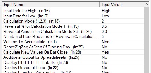

Settings are same for all charts.
image1.jpg / V - Attached On 2021-11-19 19:14:20 UTC - Size: 52.23 KB - 313 views
[2021-11-19 19:27:00]
You need to adjust the settings per chart. Refer to the information for the Zig Zag study here:
Zig Zag

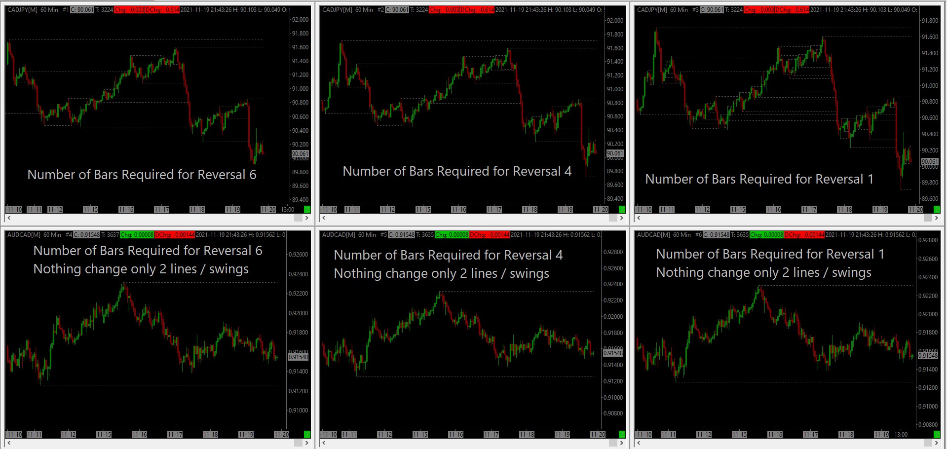

User84094 - Posts: 58
Works on upper row but not on lower row
image1.jpg / V - Attached On 2021-11-19 19:45:00 UTC - Size: 338.02 KB - 308 views
[2021-11-19 21:49:52]
You have to look at the various inputs and decide what you need to set on a per chart basis. There is no magical set of numbers that will work for all charts since the data for every chart is different. And you need to modify more than just the number of bars for reversal, you also need to modify the Reversal%/Value, and other Inputs depending on how you want them set.
[2021-11-20 09:54:20]
User907968 - Posts: 885
Everything is same except " Number of bar Required..."
And that is the problem, you using 'Mode 2', but are ignoring the effect of 'Reversal Amount for Calculation Mode 2,3'.
It is explained here - Zig Zag: Calculation Mode 2
You have it set to '0.01' for all charts, this is 1 tick on the Yen pairs, but 100 ticks on the other pairs, so not a surprise that it behaves differently.
Adjust accordingly, or even set to 0, and you will get the result you are looking for.
