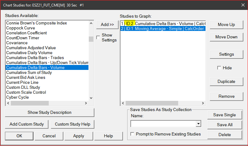

[2021-11-23 17:11:30]
Sawtooth - Posts: 4359
The ID# is not the Chart#
The ID# is the study's ID# that was assigned to it when it was added to the chart.
In the pic, the Cumulative Delta Bar - Volume study is ID2, because it was the second study added to the chart.
So the formula must reference the study's ID# to return the correct value.

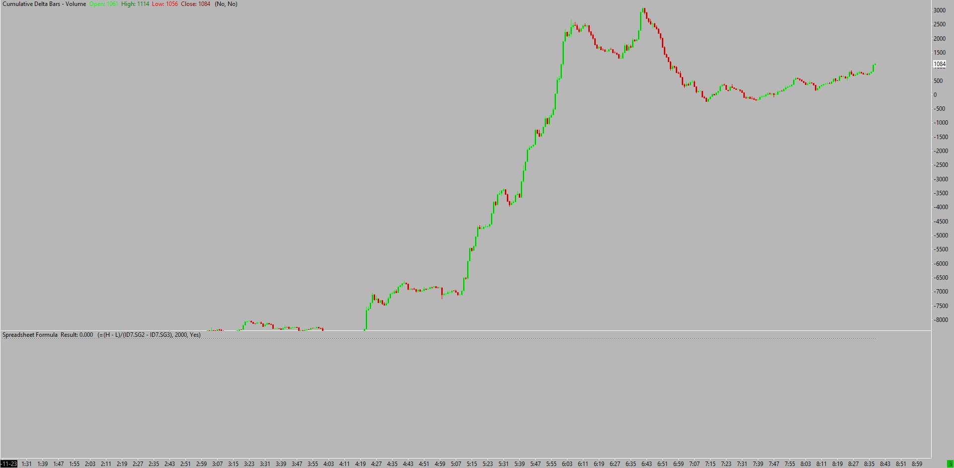

[2021-11-23 18:37:50]
ssangha84 - Posts: 132
Ok, so it looks like when I get rid of the (H-L) in the formula, the study actually populates with actual bars. So is that potentially happening because I don't have a price chart on this actual window? Right now when the formula is just the following, it seems to be working the way its supposed to: =(ID1.SG2 -ID1.SG3)
Would there be a way to incorporate the High/Low with the corresponding price bar without actually putting the price chart in this window?
imageDeltaChart2.jpg / V - Attached On 2021-11-23 18:37:31 UTC - Size: 151.53 KB - 351 views
[2021-11-23 19:43:39]
You would need to have another chart of the price bars, then overlay them to the chart with the Cumulative Delta Bars - Volume as main price graph, so that you can compare the two.
Use the Overlay (Bar) study on the Cumulative Delta Bars - Volume as main price graph chart.
Set the Chart Number to Overlay to the price bar chart#.
You can Hide this study if you want.
Then use the Spreadsheet Formula study on the Cumulative Delta Bars - Volume as main price graph chart, with a formula like this:
=(ID2.SG2 - ID2.SG3)/(ID1.SG2 - ID1.SG3)
where ID1 is the Cumulative Delta Bars study
where ID2 is the Overlay (Bar) study
Edit the formula as needed so that the correct study ID# is referenced.
