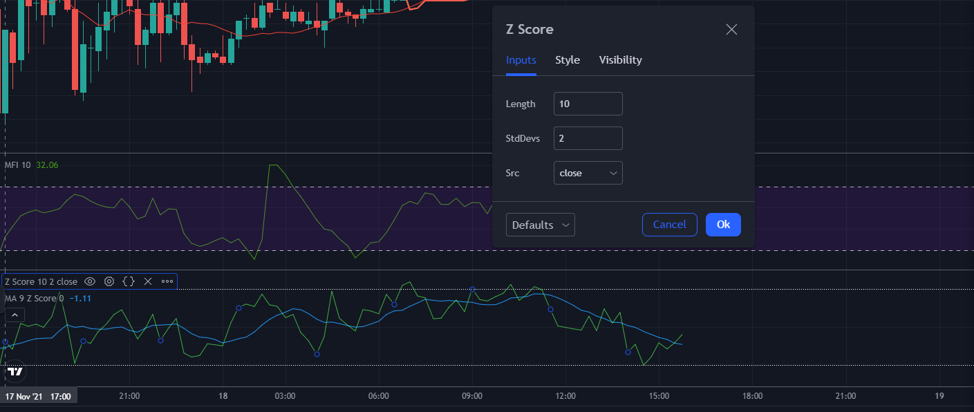

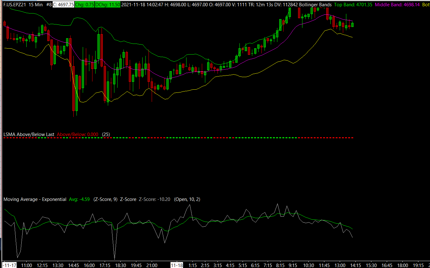

I need some help with Z-score. I was using TradingView and Thinkorswim's and I tried to use the same settings in the Z-score in Sierra Chart platform, but they both look very differently. Im uploading two screenshot to compare .
Both charts are 15mins ES future contract for December 2021.
Can you assist, so I can see it the same way as the one in TradingView ?
imageZ.score.png / V - Attached On 2021-11-18 14:00:41 UTC - Size: 78.68 KB - 571 views
imageZ.score1.png / V - Attached On 2021-11-18 14:03:16 UTC - Size: 56.31 KB - 547 views
[2021-11-18 14:25:33]
Sawtooth - Posts: 4359
One is using the Open, one is using the Close.

These are the studies from Thinkorswim:
declare lower;
input price = close;
input length = 20;
input ZavgLength = 20;
#Initialize values
def oneSD = stdev(price,length);
def avgClose = simpleMovingAvg(price,length);
def ofoneSD = oneSD*price[1];
def Zscorevalue = ((price-avgClose)/oneSD);
def avgZv = average(Zscorevalue,20);
#Compute and plot Z-Score
plot Zscore = ((price-avgClose)/oneSD);
Zscore.setPaintingStrategy(paintingStrategy.HISTOGRAM);
Zscore.setLineWeight(2);
Zscore.assignValueColor(if Zscore > 0 then color.green else color.red);
plot avgZscore = average(Zscorevalue,ZavgLength);
avgZscore.setPaintingStrategy(paintingStrategy.LINE);
And these are from TradingView:
//@version=3
study("Z Score")
Length = input(20)
StdDevs = input(2.0)
src = input(close)
basis = sma(src,Length)
zscore = (src-basis)/stdev(src, Length)
plot(zscore, color=#55FF55)
hline(StdDevs, color=white, linestyle=dotted)
hline(-1*StdDevs, color=white, linestyle=dotted)

https://i.ibb.co/WGpj3mB/Capture1.png
TradingView
These are all screenshots of the same period of time with the same length (10),the same SD2 and the same source Last/close (2) . All Im saying is that your Z-score has a strange scale and range and I want to exclude these dramatic bottoms and tops you see at the screenshot

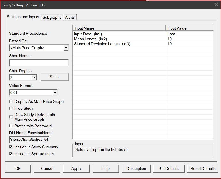

Sierra's Z-Score matches TOS's if the settings are Last, 10, 10
imageZ-Score.PNG / V - Attached On 2021-11-23 14:31:15 UTC - Size: 27.29 KB - 445 views
[2021-12-01 14:26:50]
User718690 - Posts: 18
Thanks man, you were the only one who understood what I meant. GAME CHANGER !
