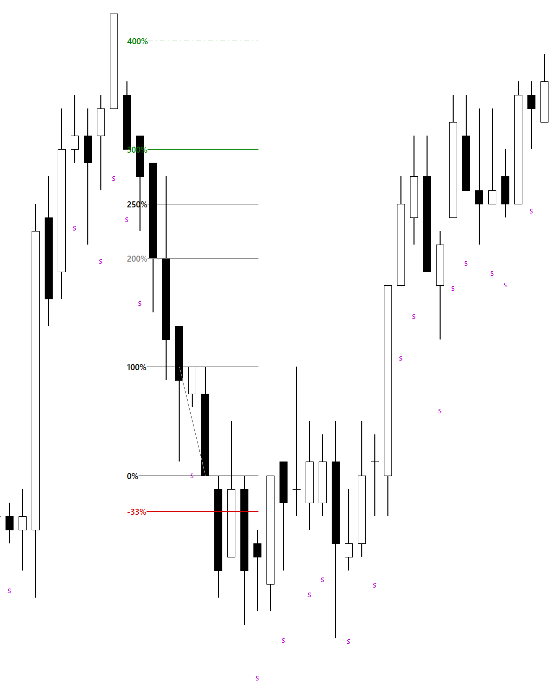

I ran into a problem with UseTool. I draw retracement on chart with UseTool and when I modify the BeginIndex, EndIndex, BeginValue or EndValue it changes one of the grid level (-33%) appearance. That grid level will change its thickness to 25 from 1 (see attached picture).
Here is the code with I draw and modify the drawing:
int DrawEntryGrid(SCStudyInterfaceRef sc, int EntryGridLineNumber, float EntryGridBeginValue, float EntryGridEndValue, int EntryGridBeginIndex, int EntryGridEndIndex)
s_UseTool Grid;
Grid.Clear();
Grid.ChartNumber = sc.ChartNumber;
Grid.Region = sc.GraphRegion;
if(EntryGridLineNumber != 0)
Grid.LineNumber = EntryGridLineNumber;
Grid.AddAsUserDrawnDrawing = 1;
Grid.AddMethod = UTAM_ADD_OR_ADJUST;
Grid.DrawingType = DRAWING_RETRACEMENT;
Grid.UseToolConfigNum = 10;
Grid.BeginIndex = EntryGridBeginIndex;
Grid.BeginValue = EntryGridBeginValue;
Grid.EndIndex = EntryGridEndIndex;
Grid.EndValue = EntryGridEndValue;
sc.UseTool(Grid);
return Grid.LineNumber;
I save the LineNumber in persistent variable after returning to be able to modify the drawing.
imagefirst_drawing.png / V - Attached On 2021-11-18 11:20:50 UTC - Size: 21.7 KB - 336 views
imagemodified_drawing.png / V - Attached On 2021-11-18 11:20:57 UTC - Size: 18.52 KB - 342 views

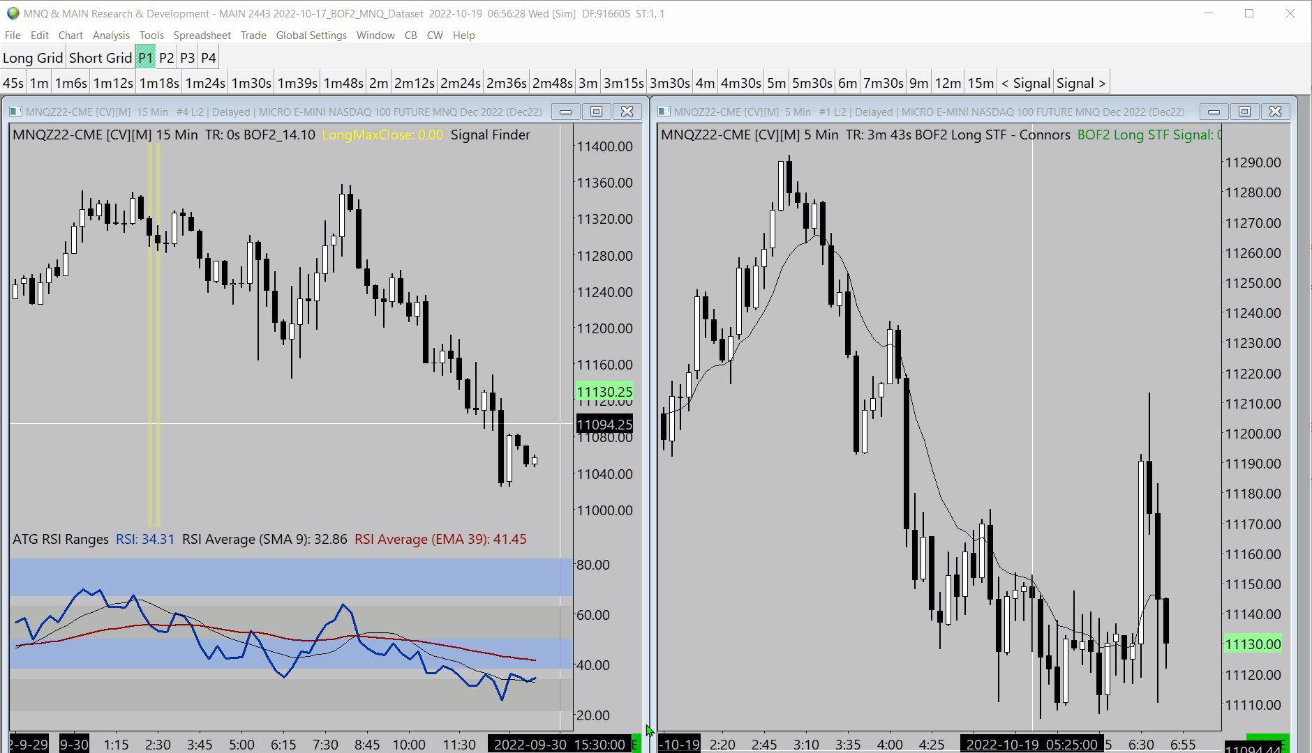

Still not working correctly, see the GIF. The linewidth modified just for the first level, if I turn it off then the problem disappears.
Date Time Of Last Edit: 2022-10-19 14:02:31
imagegrid problem.gif / V - Attached On 2022-10-19 14:00:13 UTC - Size: 4.61 MB - 224 views
