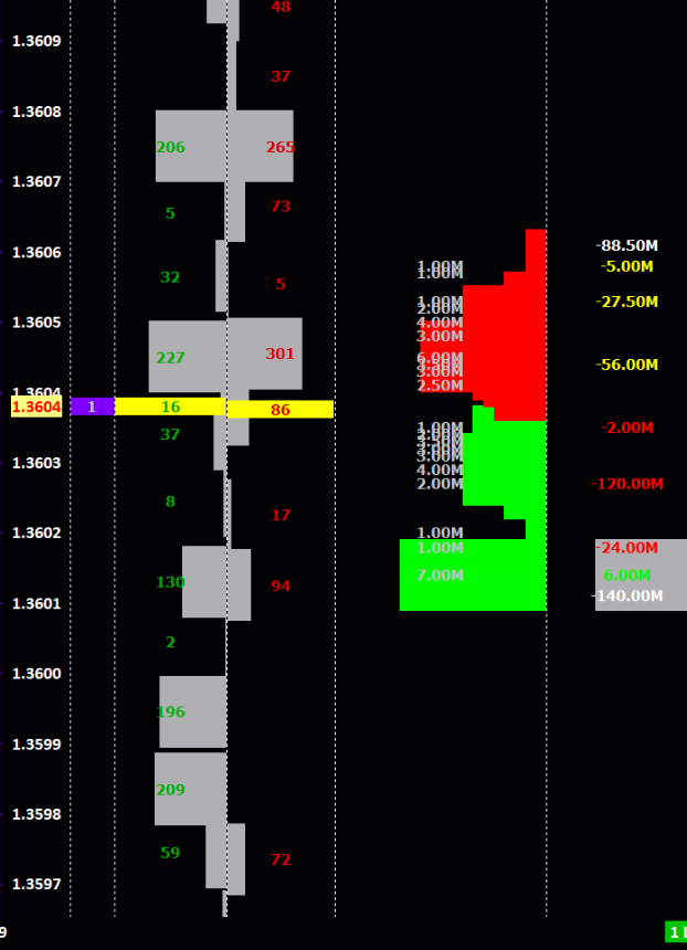

Sargon Petros - Posts: 57
Hey there, I seem to be having a similar issue with a fresh install using IB / IDEALPro where I think the tick sizes may not be quite correct.
https://www.sierrachart.com/image.php?Image=1713182943309.png
Date Time Of Last Edit: 2024-04-15 12:09:21
imageScreenshot 2024-04-15 at 8.05.28 PM.png / V - Attached On 2024-04-15 12:05:55 UTC - Size: 106.99 KB - 253 views
[2024-04-15 17:01:46]
You need to set the Tick Size to what you require. Refer to the following:
Chart Settings: Tick Size (Chart >> Chart Settings >> Symbol >> Symbol Settings menu)
And you will also want to change the "Price Display Format" based on what you are using for the Tick Size. Refer to the following:
Chart Settings: Price Display Format (Chart >> Chart Settings >> Symbol >> Symbol Settings menu)
