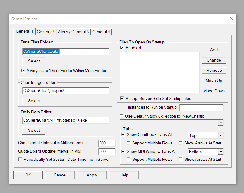

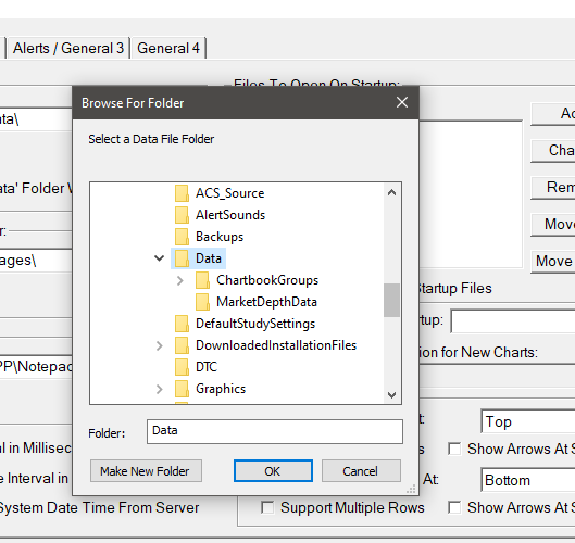

User672082 - Posts: 63
I cannot find any charts in the data files folder.
imageScreenshot_43.png / V - Attached On 2021-11-10 19:51:28 UTC - Size: 36.39 KB - 301 views
imageScreenshot_44.png / V - Attached On 2021-11-10 19:51:37 UTC - Size: 30.8 KB - 372 views
