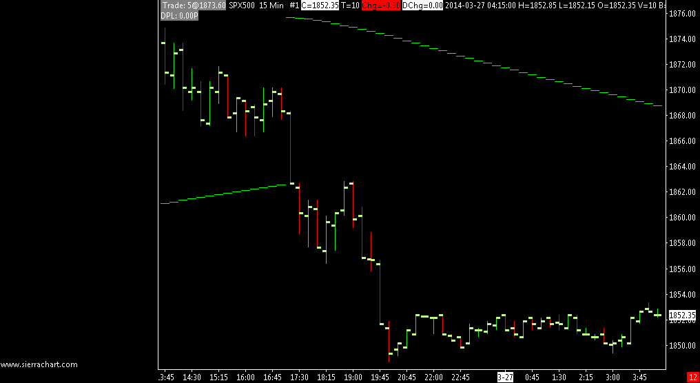

See attached, instance of indicator signal at/coincident with Low, I've also seen instances at/coincident with High; when this happens no "trade signal" is generated, I've missed some good trades.
I've tried shuffling between "signal at bar close - yes/no" and still, for that condition, no trade signal is generated.

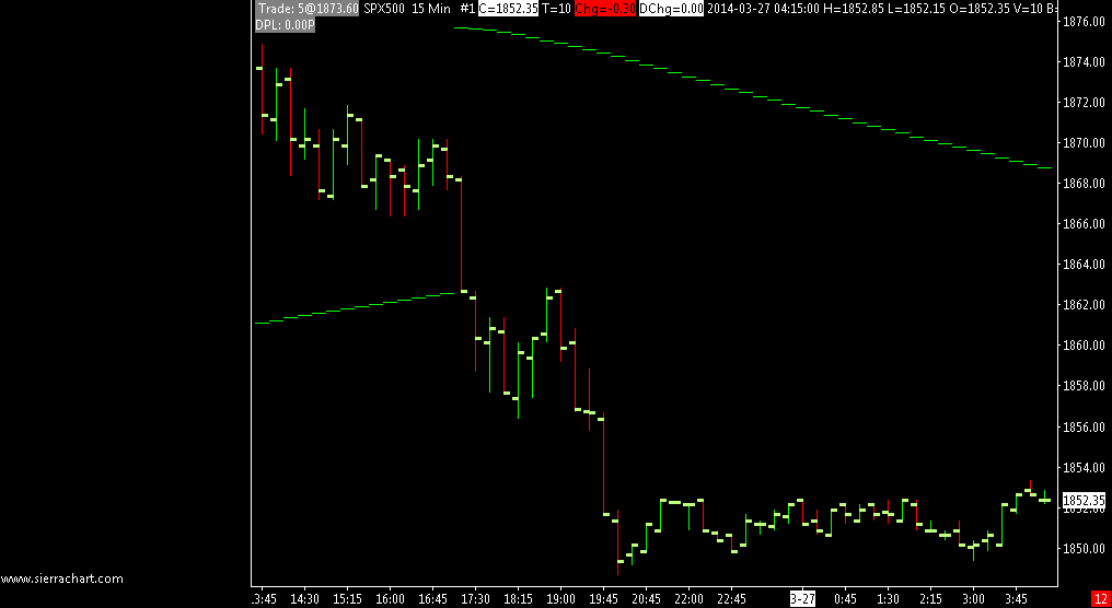

[2014-03-31 15:27:09]
Ziklag - Posts: 73
"Reset Condition on New Bar" doesn't work
[2014-03-31 17:08:12]
This is not clear for us. So you are working with the parabolic study?
Are you referring to Simple Alert formula or to the Spreadsheet study?
[2014-03-31 17:47:09]
Ziklag - Posts: 73
true, I work with parabolic study and true, I'm referring to Spreadsheet System for Trading (Send Orders To Trade Service);
its as if Spreadsheet System for Trading is "a tick out of sync with the parabolic study" in that Spreadsheet System for Trading generates trade order/signal on subsequent, one or two, tick(s) above and/or below the parabolic study signal, for long and/or short trades as the case may be;
consequently in the case that the parabolic study signal was at/coincident with Low and/or High then Spreadsheet System for Trading doesn't get/detect signal for that bar YET parabolic study will not signal again until after trend change - so a move is missed.
If "Reset Condition on New Bar" worked it could 'manage' the situation by 'reminding' Spreadsheet System for Trading about signal on the previous bar.
What is needed to make Spreadsheet System for Trading order/signal coincident (sync) with parabolic study signal; in the picture attached, and I saw several instances before raising the issue, parabolic study generated signal but Spreadsheet System for Trading didn't!
imageSPX500 15 Min #1 41729.575.png / V - Attached On 2014-03-31 17:46:55 UTC - Size: 29.21 KB - 477 views
[2014-04-02 00:25:27]
This is an advanced usage question which is outside the scope of our support.
