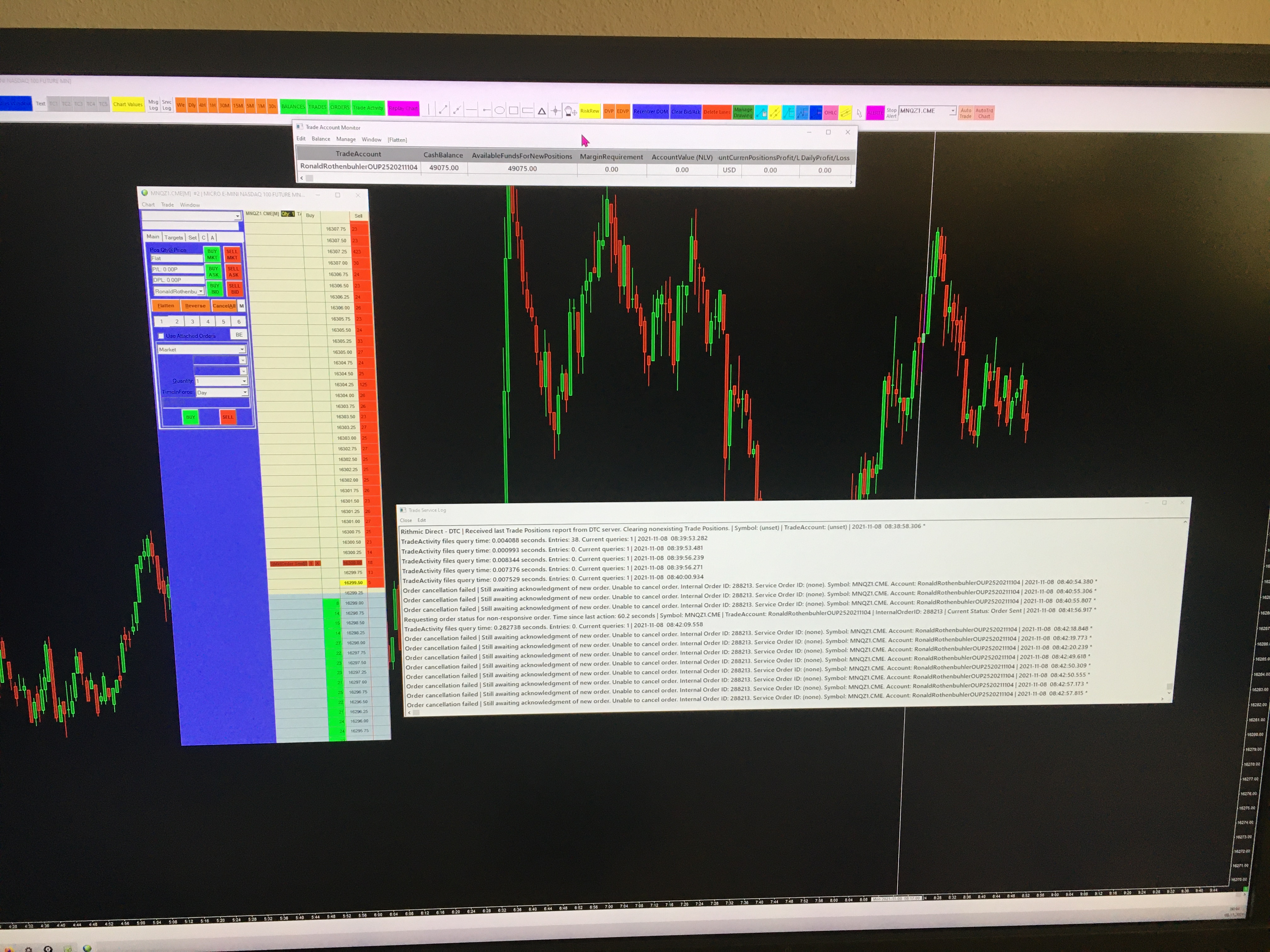

[2021-11-08 08:27:47]
rrothenbuhler - Posts: 7
I did try again this morning but no trade again.
Best
Ronald
imageIMG_4557.JPG / V - Attached On 2021-11-08 08:26:35 UTC - Size: 2.47 MB - 307 views
imageIMG_4556.JPG / V - Attached On 2021-11-08 08:26:42 UTC - Size: 2.49 MB - 341 views

[2021-11-08 15:26:26]
Sierra_Chart Engineering - Posts: 25390
Based upon what we see in post #6, the Rithmic server is not responding to an order you have submitted. We want to get more details about this so we can submit to Rithmic. Follow the instructions here to get us the lines from the Trade Activity Log for that order:
Trade Activity Log: Providing Trade Activity Log Data Lines to Support (Providing Trade Activity Log Data to Support)
Regarding post #7, is this with an actual live trading account or with a service like this One up trader? There are other supported Trading services you can use instead of Rithmic:
Supported Data and Trading Services
Date Time Of Last Edit: 2021-11-08 16:33:00

Trade Order Error - Order timed-out waiting for response from service/exchange server. Internal Order ID: 2176. Service Order ID: (none). Symbol: RTYZ1.CME. Account: RonaldRothenbuhlerOUP2520211104 | 2021-11-09 08:42:40.055 *
Order cancellation failed | Still awaiting acknowledgment of new order. Unable to cancel order. Internal Order ID: 2177. Service Order ID: (none). Symbol: RTYZ1.CME. Account: RonaldRothenbuhlerOUP2520211104 | 2021-11-09 08:44:10.801 *
Requesting order status for non-responsive order. Time since last action: 59.2 seconds | Symbol: RTYZ1.CME | TradeAccount: RonaldRothenbuhlerOUP2520211104 | InternalOrderID: 2177 | Current Status: Order Sent | 2021-11-09 08:45:10.113 *
Trade Order Error - Order timed-out waiting for response from service/exchange server. Internal Order ID: 2177. Service Order ID: (none). Symbol: RTYZ1.CME. Account: RonaldRothenbuhlerOUP2520211104 | 2021-11-09 08:45:40.113 *
Order cancellation failed | Still awaiting acknowledgment of new order. Unable to cancel order. Internal Order ID: 2178. Service Order ID: (none). Symbol: RTYZ1.CME. Account: RonaldRothenbuhlerOUP2520211104 | 2021-11-09 08:47:02.534 *
Order cancellation failed | Still awaiting acknowledgment of new order. Unable to cancel order. Internal Order ID: 2178. Service Order ID: (none). Symbol: RTYZ1.CME. Account: RonaldRothenbuhlerOUP2520211104 | 2021-11-09 08:47:24.219 *
Requesting order status for non-responsive order. Time since last action: 55.8 seconds | Symbol: RTYZ1.CME | TradeAccount: RonaldRothenbuhlerOUP2520211104 | InternalOrderID: 2178 | Current Status: Order Sent | 2021-11-09 08:48:20.183 *
Trade Order Error - Order timed-out waiting for response from service/exchange server. Internal Order ID: 2178. Service Order ID: (none). Symbol: RTYZ1.CME. Account: RonaldRothenbuhlerOUP2520211104 | 2021-11-09 08:48:50.245 *
[2021-11-10 14:45:49]
We have to let Rithmic know about this. This is going to be a Rithmic server issue.
What is the time zone, of that log above?
Date Time Of Last Edit: 2021-11-10 14:46:40
[2021-11-11 14:59:38]
We have an answer from Rithmic. We really needed the Trade Activity Log data in order to clearly identify the problem but we know what the issue is.
Your account identifier is longer than 31 characters. It needs to be shortened to no more than 31. Contact your account provider and have them resolve this.
Let us know you received this response.
Date Time Of Last Edit: 2021-11-11 15:00:02
