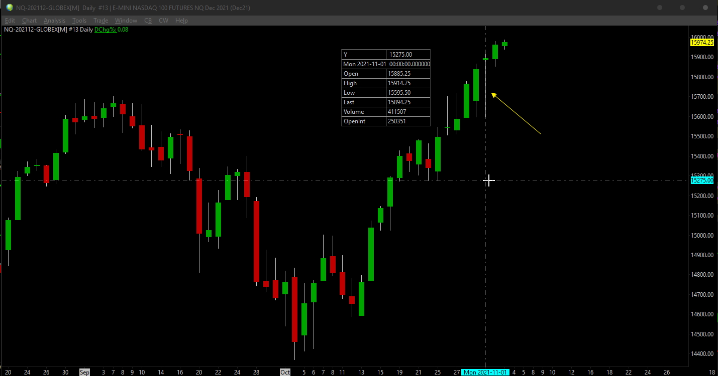

I have been noticing that for some time now the Denali Historical Data (Daily) has been occasionally wrong for NQ and MNQ Globex Futures. I don't know if there are more instruments with the same problem, because I only follow these two.
Yesterday's candle (2021-11-01) is an example where this issue is very notorious, as you can see in the attached screenshot.

imageImage 1.jpg / V - Attached On 2021-11-02 19:25:42 UTC - Size: 104.87 KB - 387 views

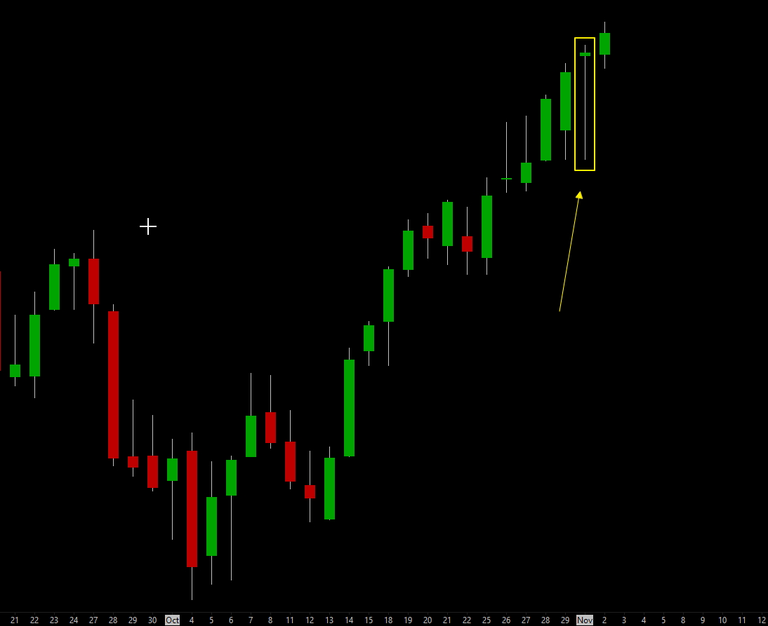

The symbol in this case is NQ-2021-GLOBEX, but the very same problem also happens with MNQ-2021-GLOBEX.
I don“t know about other instruments, I am currently just trading these two instruments with Sierra Chart.
I am attaching two screenshots of the chart as you requested, pointing out an example where it is easy to check the error.
See what you can do please. This issue is very misleading.

imageImage 2.jpg / V - Attached On 2021-11-03 10:49:26 UTC - Size: 208.94 KB - 352 views
imageImage 3.jpg / V - Attached On 2021-11-03 10:49:37 UTC - Size: 238.04 KB - 399 views
