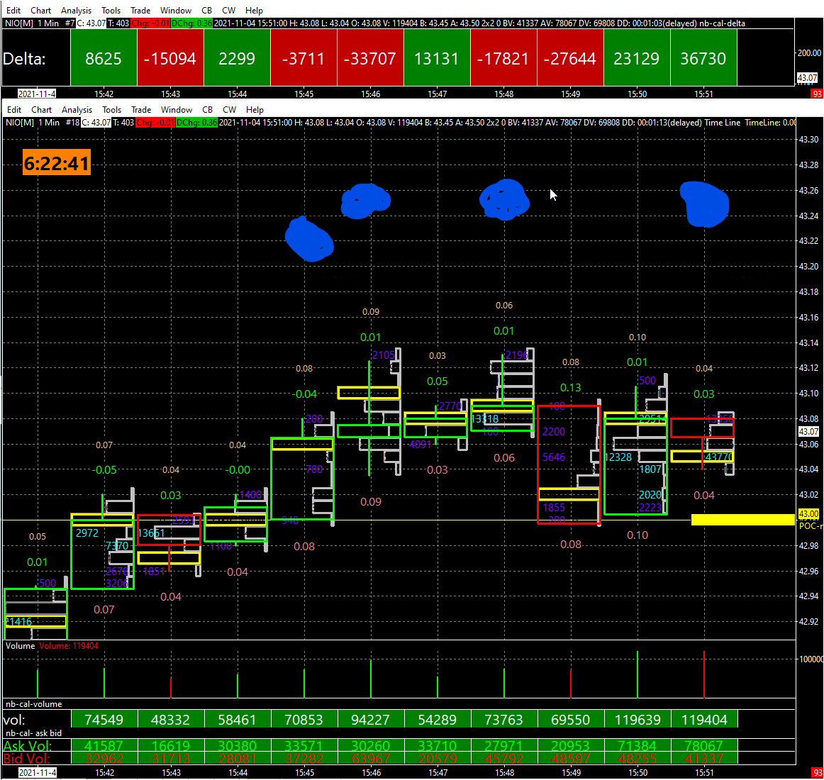

[2021-11-05 10:32:46]
User278398 - Posts: 296
thank u for your response.
in the photo i attached u can see an example for what im looking for.
i want a mark on the chart candle when the delta number (positive/negative) is different from the color of the candle stick in the chart. (for example, if the delta number is positive (green color) and the candle stick is "negative" (red color, go relative down), then i will see a mark on the chart (like in the example attached photo)...

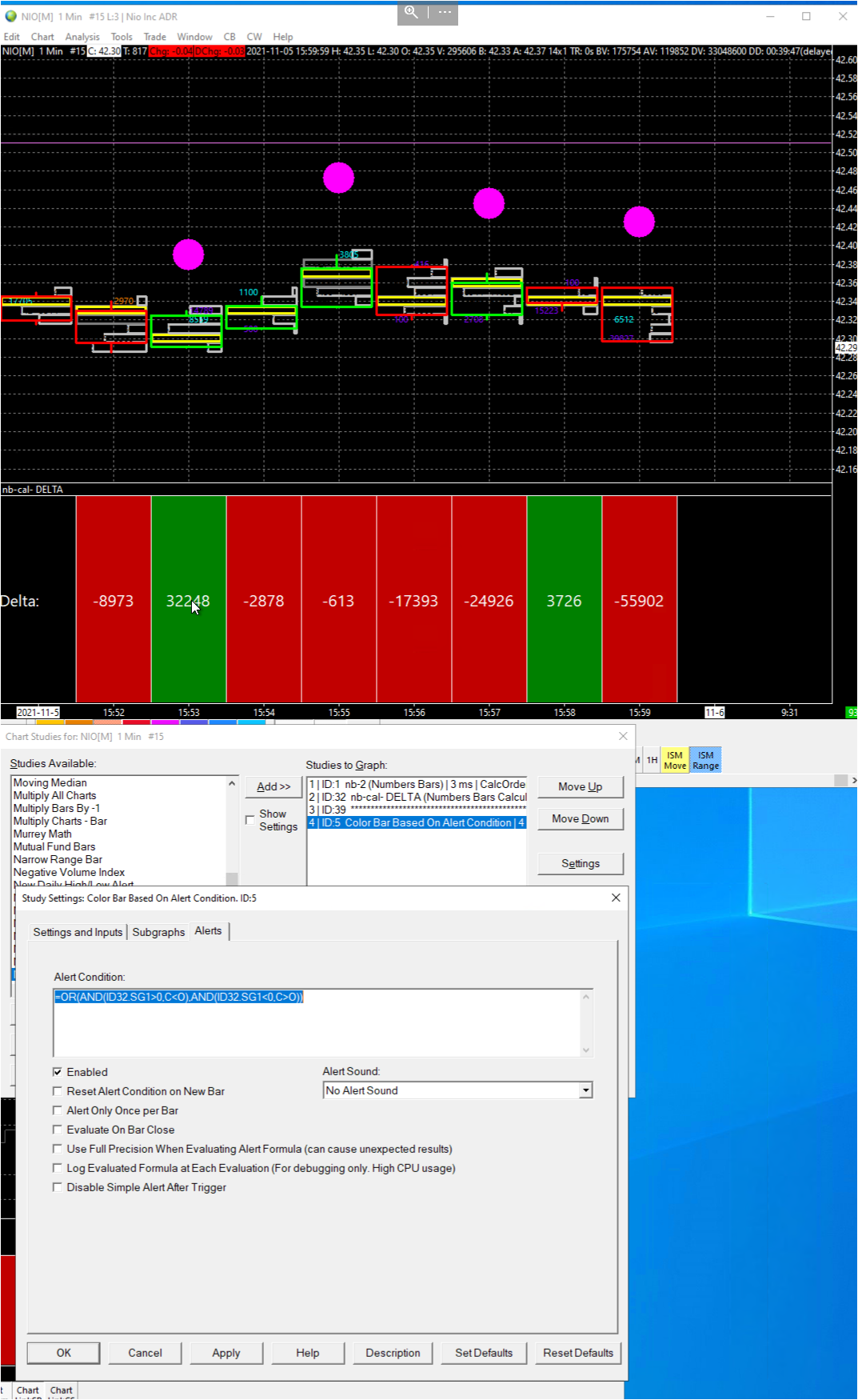

[2021-11-05 16:36:40]
VERY NICE SOLUTION!
YOUR Equation LOOKS GOOD, BUT I DONT GET A GOOD VALUES.
(i try allso with color background based on alert, study and i got the same resuls)
*PICE ATTACHED
image3.png / V - Attached On 2021-11-05 16:33:39 UTC - Size: 824.49 KB - 404 views
[2021-11-05 17:24:09]
i found the problem.
=ID42.SG1>0 work good with displacement set to -1 (in subgraphs)
and
=c>o work good when displacement set to 0 (in subgraphs)...
how can i write the formula for Delta that the displacement will be to 0 (and not to -1) ?
Date Time Of Last Edit: 2021-11-05 17:40:00
[2021-11-05 18:48:25]
Sawtooth - Posts: 4361
There is no need to set the Displacement to anything other than 0.
Which SG# of the Numbers Bars Calculated Values study are you using for your 'Delta' ?
[2021-11-06 08:31:16]
sg1
image444.png / V - Attached On 2021-11-06 08:31:08 UTC - Size: 413.6 KB - 385 views
[2021-11-06 14:10:54]
As a test, change your data feed to SC Data - All Services
and in Chart Settings, change the Symbol to ESZ21-CME
This setup works accurately for me.
