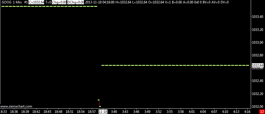

When I open a chart, it only loads data from last year.

[2014-03-31 03:07:08]
User21245 - Posts: 7
Done.
http://www.sierrachart.com/image.php?l=1396235184640.png
[2014-03-31 03:15:49]
In that Intraday chart it is not scrolled to the very end.
Before taking an image of the chart, select Chart >> Goto End of Chart.
We also notice that you are using Interactive Brokers, so you will have a minefield of problems getting a lot of Intraday data. Sounds like you might be encountering pacing violations:
http://www.sierrachart.com/index.php?l=doc/helpdetails37.html
If so, the only help we provide is to refer you to help topic 37.
If you want to look at a lot of historical Intraday data, the only solid choice is to use the Sierra Chart Historical Data Feed:
https://www.sierrachart.com/index.php?l=doc/SierraChartHistoricalData.html
Do not waste your time with Interactive Brokers. Only use Interactive Brokers for short-term Intraday charts. Going only back about 10 to 15 days.

[2014-03-31 18:55:45]
I was only trying to load 5 days of historical days (the most recent 2) and Sierra Charts returned 2 years of data ending 5 months ago.
[2014-03-31 19:19:05]
We realize what part of the problem is. In Global Settings >> Data/Trade Service Settings, the Maximum Historical Intraday Days to Download setting most likely is set to 186 which is the default. This works fine with all other services supported by Sierra Chart. In the case of Interactive Brokers it should be a small number like 15.
Recently we made this setting common across all supported services but did not consider how it is going to cause a problem with Interactive Brokers.
Nevertheless, we did explain previously in a prior post in this thread that most likely you are getting "pacing violations" from IB and linked you to the relevant help topic which explains how to solve this. Here it is again:
As far as getting two years of data, we do not know how you determined that. In any case it would be because the data already existed for the symbol from another service you were using Sierra Chart with. Or you had increased the Maximum Historical Intraday Days to Download.
