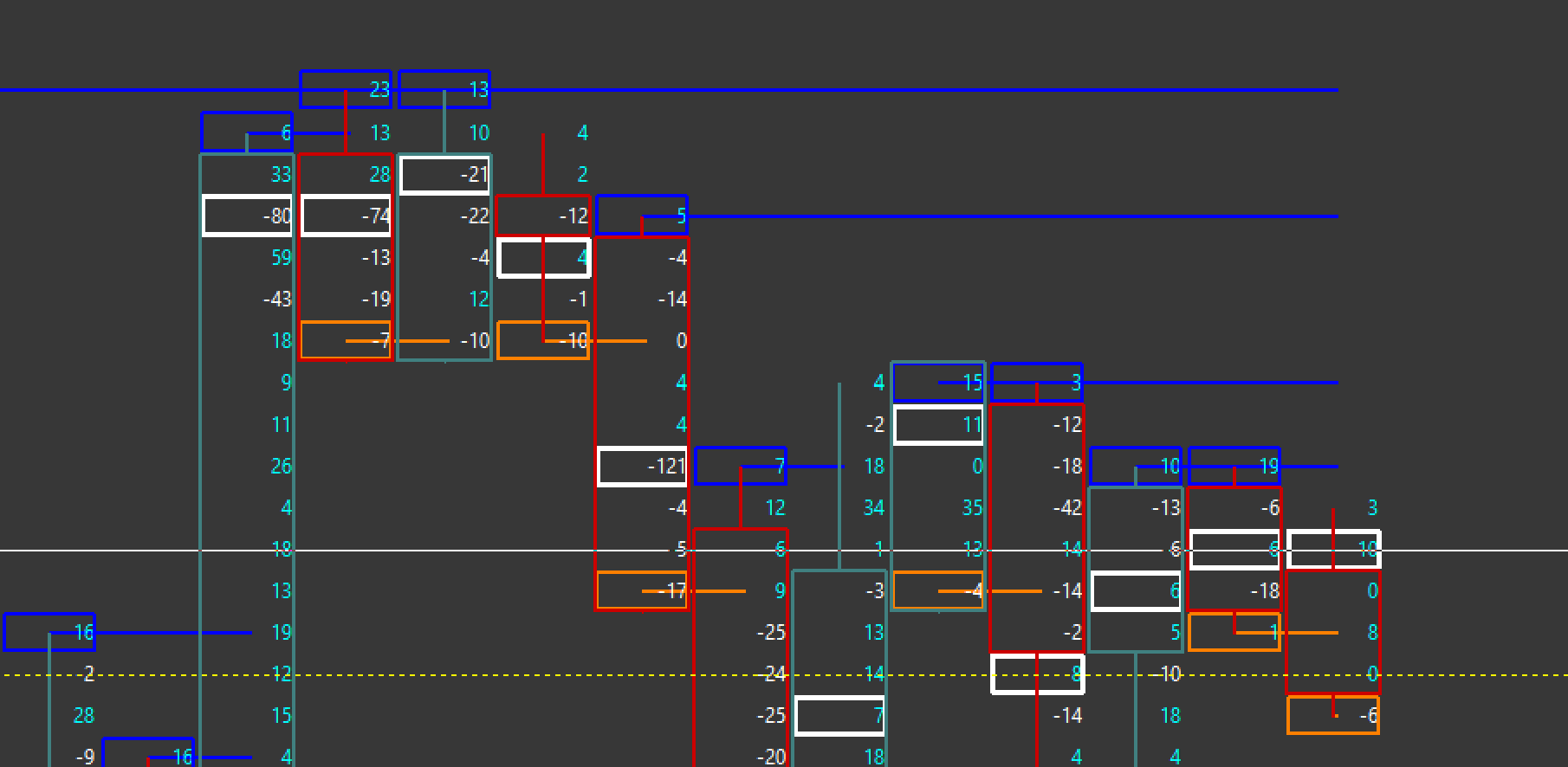

Hey Guys, i want to set up a Delta Footprint/Numbers Bars like in the attachment picture.
Like you see in the attachment. Bid Delta shows up in the left bar site and Ask Delta on the right site.
As far as i set it up delta shows up only only the right site. ( See attachment )
thanks

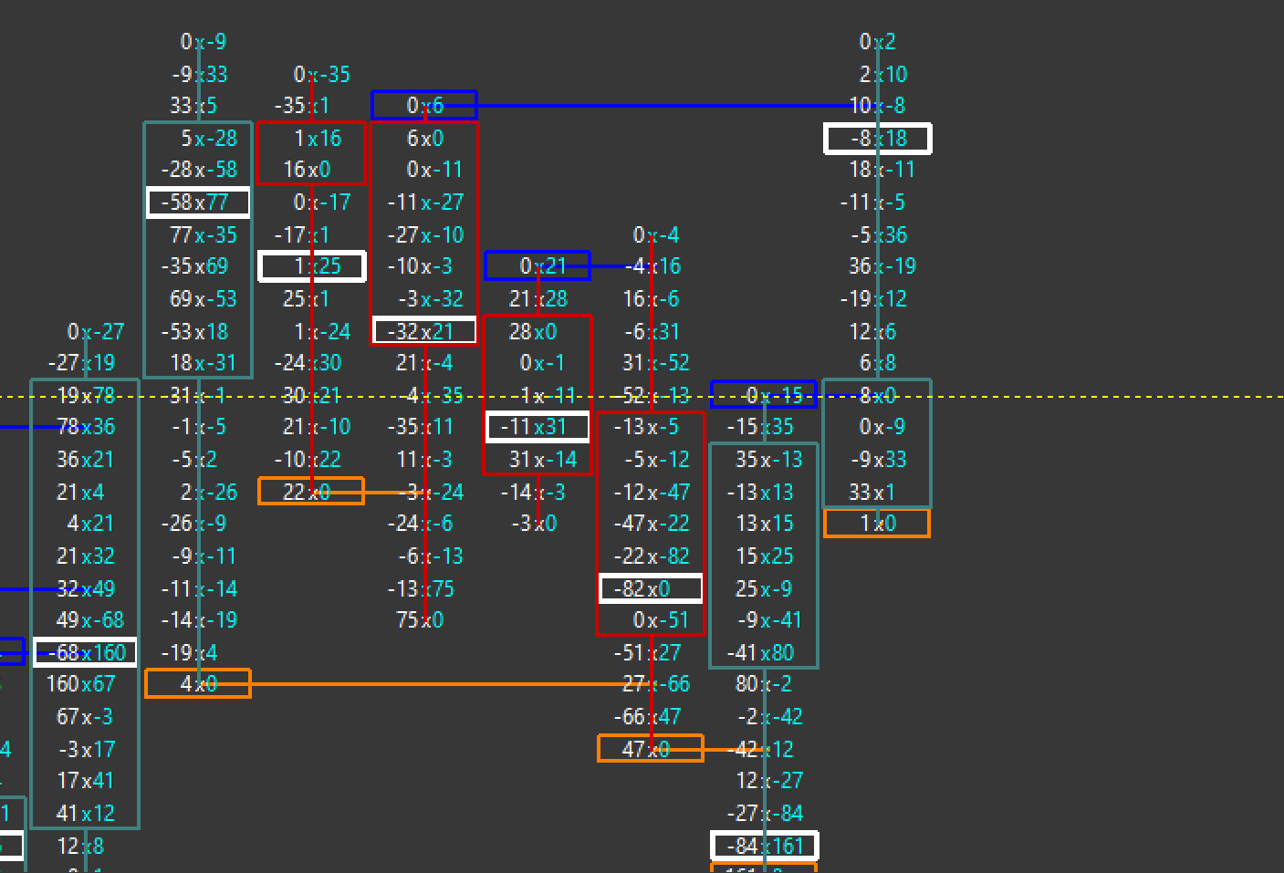

You would need to set the Column x Numbers Bars Text to Ask Vol Bid Vol Difference Diagonal to see the numbers on both sides. You can then color the numbers as you want, and set the Default Text Color to be the same as your background so you will not see the values that are not specifically colored.

Daniel Widmar - Posts: 24
Hey when i set it up as described it ends up unusable to read.
Please check attachment pictures:

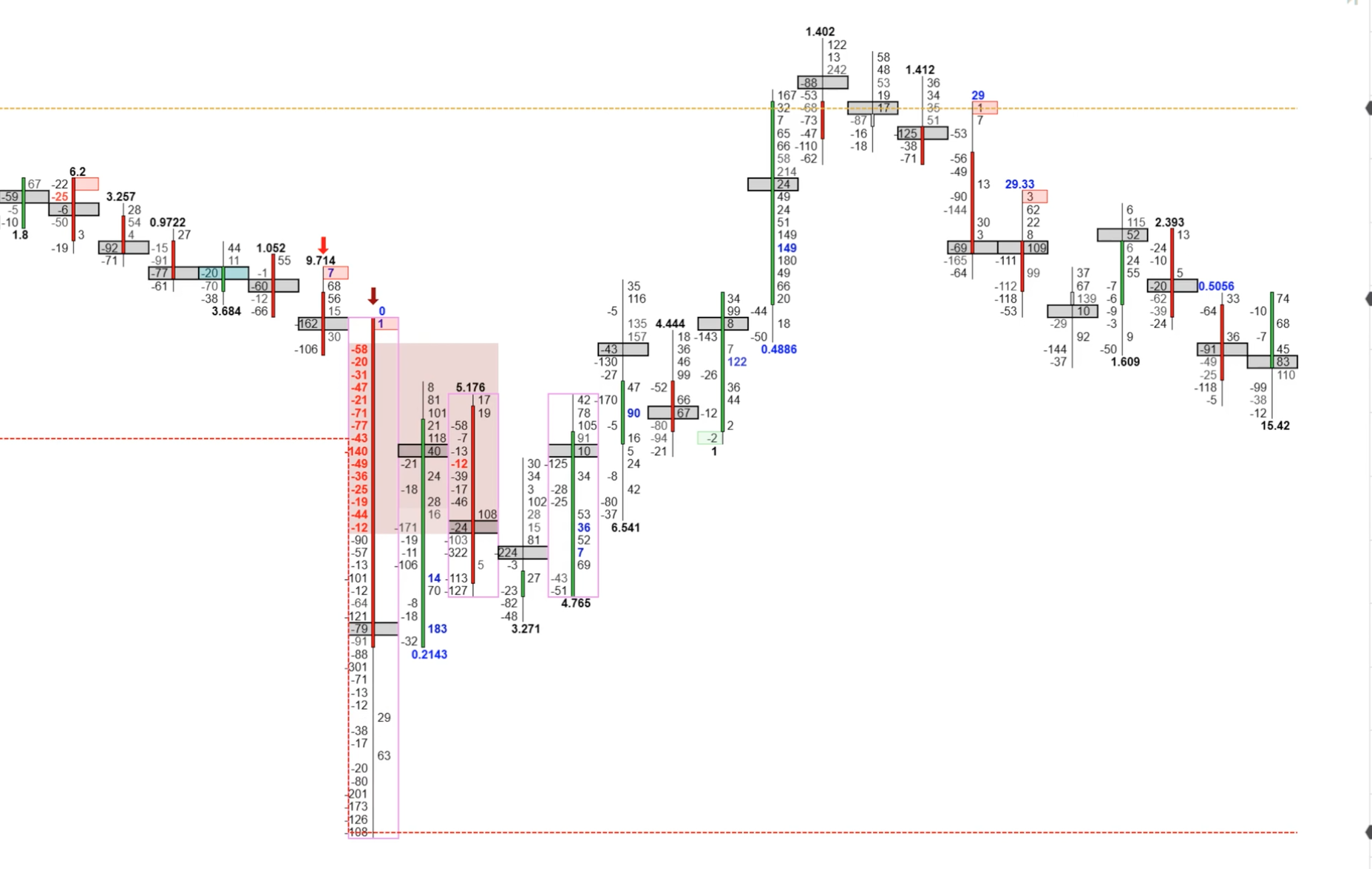

I also send you again the picture of the Delta footprint i want to set up.
thanks

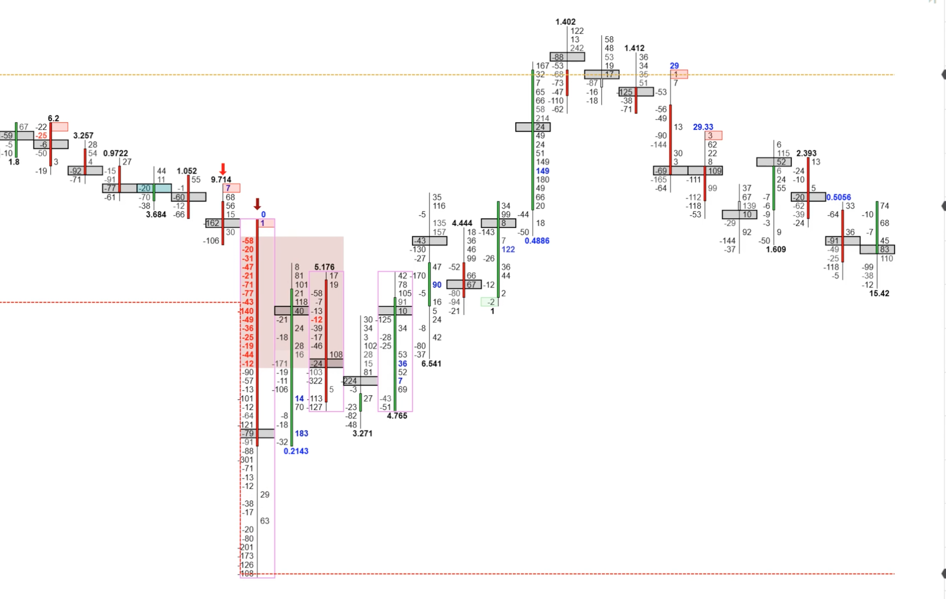

Hey, i want a delta footprint with negative delta on the left site of the bar/bids and positive delta on the right site/ask. This is exactly what you see in the picture. Shows delta at each price in the bar.

Are you wanting diagonal delta or straight across delta?
[2021-11-05 10:33:27]
Hello, i want to set it up straight across delta.
[2021-11-05 14:06:05]
There is not an option to get the straight across delta to show the Bid and Ask on different sides. That is only available with the Diagonal Delta.
