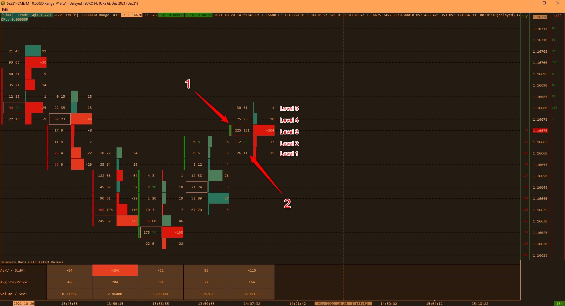

I would like to program a few indicators in the footprint chart and hope that someone can help me.
It is a 6 range chart like the one in the picture.
Question 1: With which formula do I get the total volume of level 3 as a result? 225 + 121 = 346
Question 2: With which formula do I get the purchase volume of level 1 as a result? 11
What kind of programming are you looking to do? Is this an ACSIL custom study, an Alert, Spreadsheet, something else?

thank you for helping me. I want to program a Color Bar Based Alert Condition.
For example
= (Bid Volume Level 1 + Ask Volume Level 1)> (AV_total + BV_total) / 2
= (Bid Volume Level 5 + Ask Volume Level 5)> (AV_total + BV_total) / 2
= (Ask Volume Level 1)> (AV_total + BV_total) / 4
= (Bid Volume Level 5)> (AV_total + BV_total) 4
I have only just started working with Sierra Chart and have here Study/Chart Alerts And Scanning: Available Main Price Graph Identifiers/Variables
No information was found on how I can determine the volume on the individual levels in a range chart.
thanks
Anna

You really need to look at the next section of that documentation, which gives you the way to get the Volume at Price information. You will find the information you need here:
Study/Chart Alerts And Scanning: Special Functions

Hello John,
Thank you for your support. That helped me.
