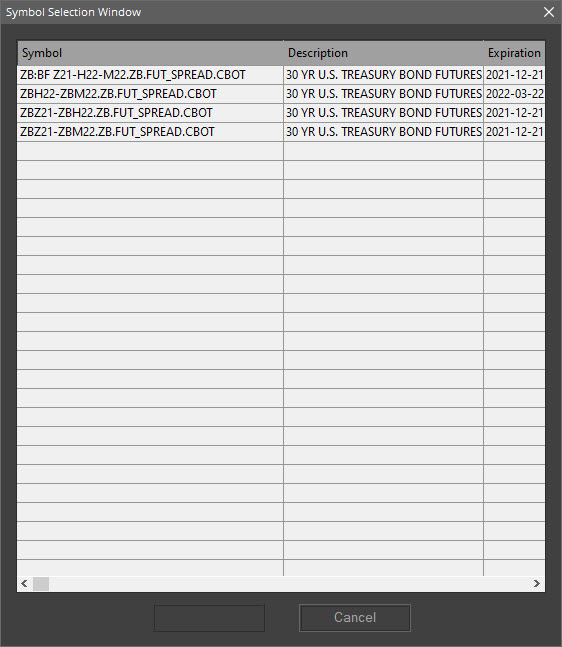

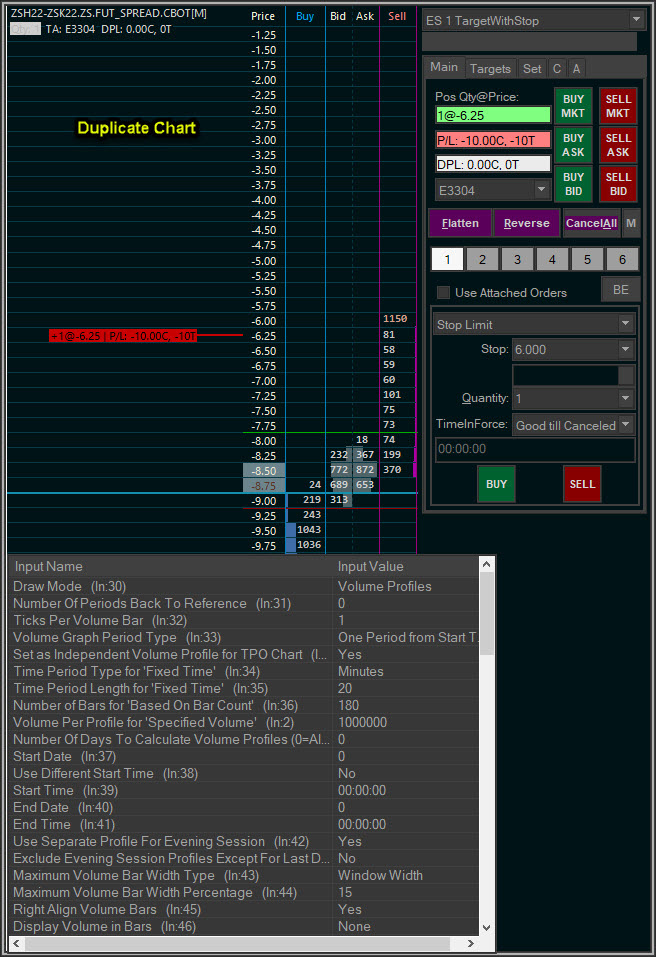

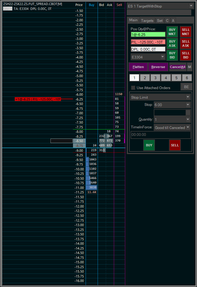

Having an issue with several spreads and the Volume by Price Study. Several weeks ago I started getting strange looking VbP histograms of only a single price (see the first attachment). When I duplicate a chart/DOM it doesn't show any VbP (second attachment). This one's ZS, but there are others mostly in the Grains (CBOT). Energy products (NYMEX) and Metals (COMEX) seem to be normal.

It looks like your setting for the Volume Graph Period Type is One Period from Start Time to End Time. If this is the case, then that is the problem, as that particular option does not calculate properly on the Trading DOM. We have updated the code to ensure that if selected, then it will change to the One Period from Session Start Time to End, when OK, or Apply is selected. This is the current method for any of the other options that are not available on the Trading DOM.
This change will be in the next Pre-Release (v 2323).
If you have a different Graph Period Type selected, then let us know and we will look into the issue further

What about the shortened list of spreads for ZB and others I didn't mention. Will you look in to that? Or, should I open another support thread?

It is doubtful there is any problem on the Sierra Chart side with the listing of spreads for ZB. Tell us what particular spread you are looking for and we will check the master security definition file from the CME and see if it is in there.

Maybe you're right. I just expected to see a lot more spreads, like in other products (ZC for instance). Here's a few symbols that I would expect to see in the list. They are not too far out to trade.
ZBZ21-ZBU22.ZB.FUT_SPREAD.CBOT
ZBH22-ZBU22.ZB.FUT_SPREAD.CBOT
ZBH22-ZBZ22.ZB.FUT_SPREAD.CBOT
Thanks.

Sierra_Chart Engineering - Posts: 24949
We searched this file:
ftp://anonymous:anonymous@ftp.cmegroup.com/SBEFix/Production/secdef.dat.gz
For:
ZBZ1-ZBU2
It does not exist.
Also note that years in that file use a single digit.
