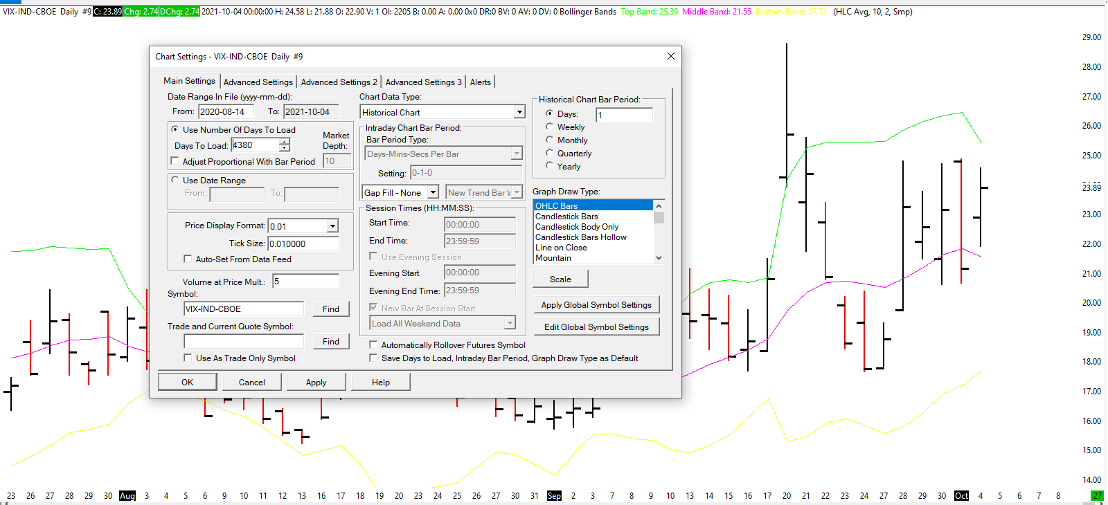

[2021-10-07 14:48:47]
SKZ90 - Posts: 75
I don't know how to make it download to the current date.
I disconnect and reconnect and it didn't work
imageUntitled.png / V - Attached On 2021-10-07 14:48:02 UTC - Size: 82.07 KB - 333 views

[2021-10-07 18:42:25]
SKZ90 - Posts: 75
I get an invalid symbol error.
Attached picture.
imageUntitled.png / V - Attached On 2021-10-07 18:41:56 UTC - Size: 31.62 KB - 277 views
[2021-10-07 23:39:48]
Our servers indicate that your Current Selected Service is set to SC Data - All Services. If this is correct, then that is not the correct symbol for the VIX index. The symbol is $VIX in this case.
The easy way to change it (and any other symbols that are not correct, if you have any) is to select Edit >> Translate Symbols to Current Service.
[2021-10-07 23:47:34]
SKZ90 - Posts: 75
That fixed it.
