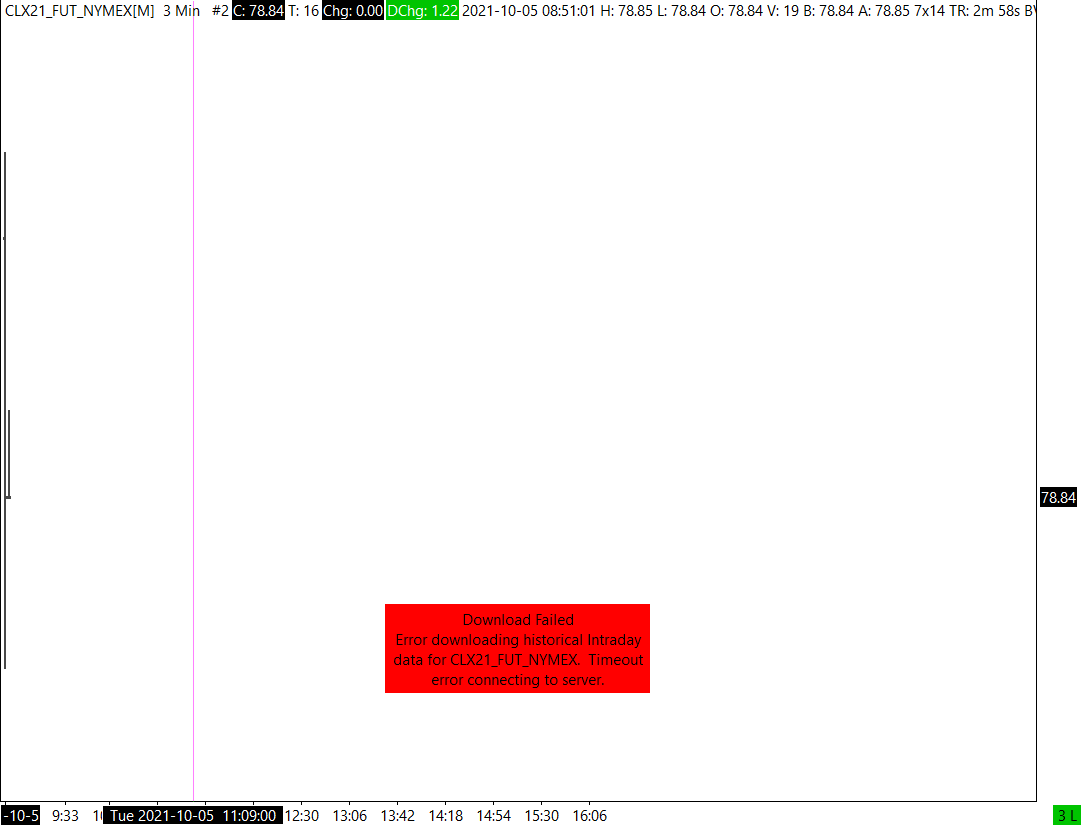

I've checked my internet and is fine. Even I have other instance of Sierrachart with equities data.
But I have this error to get chart in CLX21. I tried several times EDIT>>EDIT ALL DATA AND DOWNLOAD. but it isn't working.
http://www.sierrachart.com/image.php?Image=1633438263818.png
Please help.

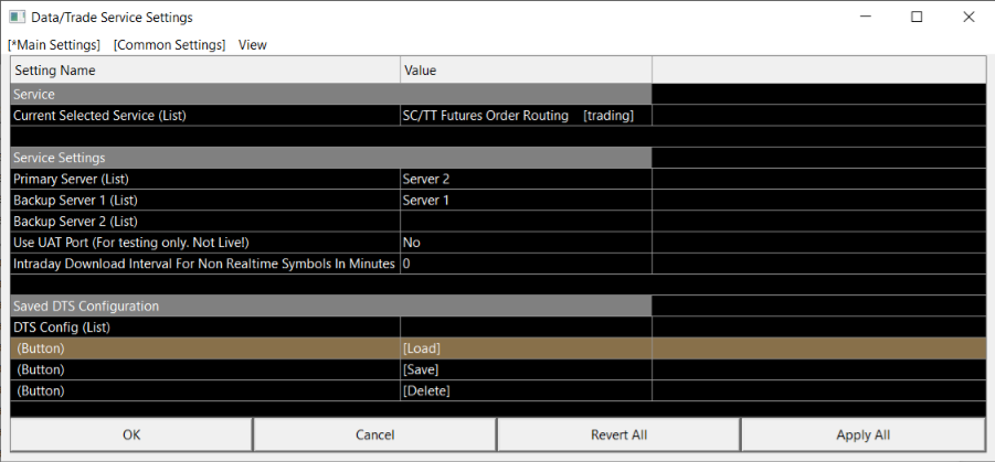

I don't see SC Server Settings button to enbable use port 80
image2021-10-05_11-18-20.png / V - Attached On 2021-10-05 16:19:34 UTC - Size: 75.25 KB - 224 views
[2021-10-05 16:44:58]
We apologize. That documentation is out of date. We are updating it now.
