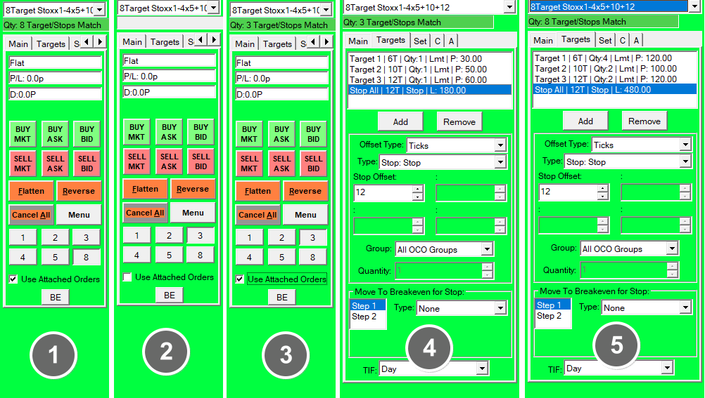

[2021-10-20 15:22:05]
nicktrader - Posts: 813
I have tested it twice times (2320 + 2322) and from my point of view nothing has changed. Below see pic
#1 - Standard template with 8 contracts (3 targets and 1 Stop)
#2 - unchecked and quantity changed to 3
#3 - reenable (green says 3 accepted)
#4 - split at 3 pieces
#5 - reload of the template and after that everything is ok again
Many thanks
