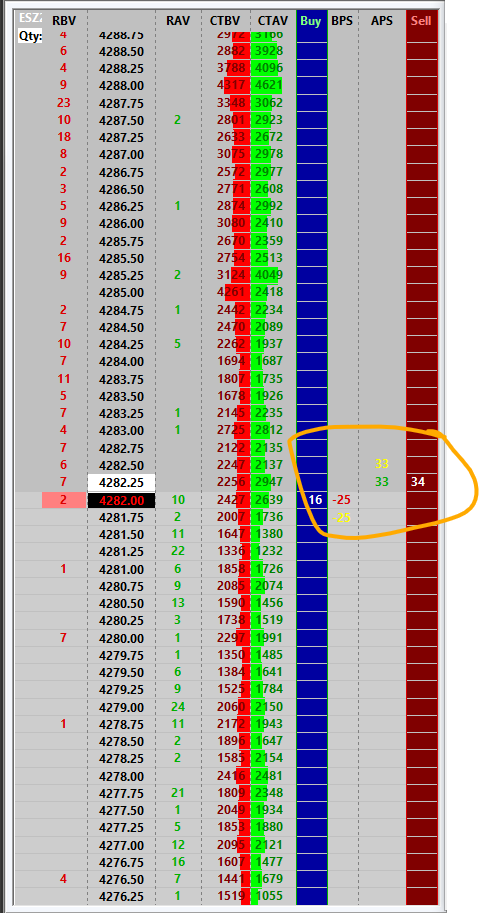

Dear Support,
I'm trying to setup my DOM using its own Graphic Settings and not Global Settings. However, no matter what I try, I can't seem to change the color of the Chart Text and Dom Quantities text.
I can change the font / size / style, but not the color.
Please see attachment on the text color that I want to change.

[2021-10-04 11:39:46]
You need to use this setting:
Customizing Fonts, Colors, Line Styles, and Widths for Chart Trading, Chart DOM, and Trade DOM: Trade DOM Values Scale Text

Thank you. While I have you here, in my DOM, for the bid / ask pulling / stacking on ES, I only see 1 level. Is that normal? I thought I can see way more than just 1 level.
I have set my Max Bid/Ask Depth Pulling/Stacking Levels to 0

[2021-10-04 17:44:53]
It is normal given that you do not have any exchanges active that have the Market Depth data included. This is the same reason why you only have 1 depth level in the Bid/Buy and Ask/Sell columns.
If you want to change your exchange selections, then you can do so from the following page:
https://www.sierrachart.com/UserControlPanel.php?page=DenaliDataFeed#Exchanges
Just keep in mind that when you activate an exchange, you will pay the full amount for the remainder of the month in which you activate it.

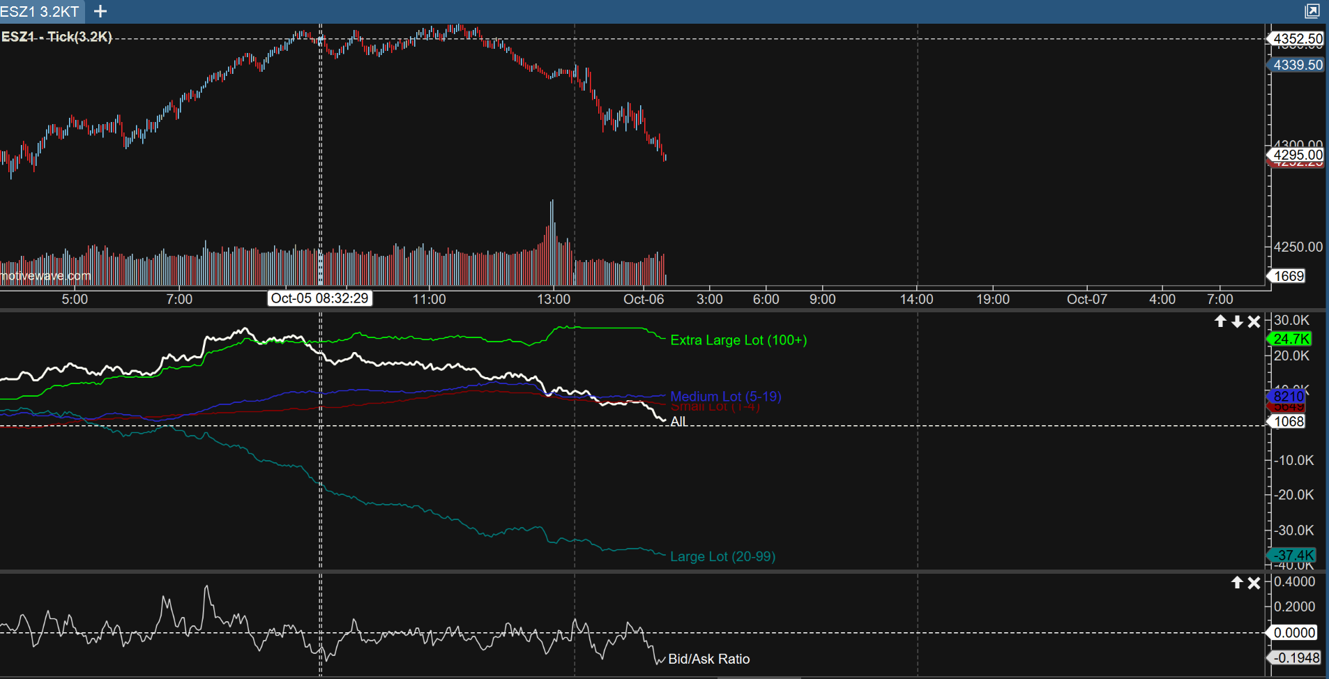

Thank you. I saw this indicator on plotting order size at different values (I think from Rithmic). Does Sierra have a similar study?

[2021-10-06 16:43:21]
We do not have anything that looks similar to that. But we are not exactly sure what it is showing, as it does not make any sense that the "All" line is in the middle of the data and not above all the rest.
If you can tell us what exactly is being displayed by that indicator then we can see if there is a way to put together studies to get the information you want.
[2021-10-06 21:52:05]
Thang N - Posts: 11
It's basically the delta, but broken into different lot sizes. So the "all" line is the total delta of the current session.
Then each other color line is delta of orders within that size only (like green is 100+ size, teal is 20-99, etc.)
[2021-10-07 00:28:02]
This would be something that you would have to program using our ACSIL interface. For information, refer to the following:
Advanced Custom Study Interface and Language (ACSIL): Introduction
