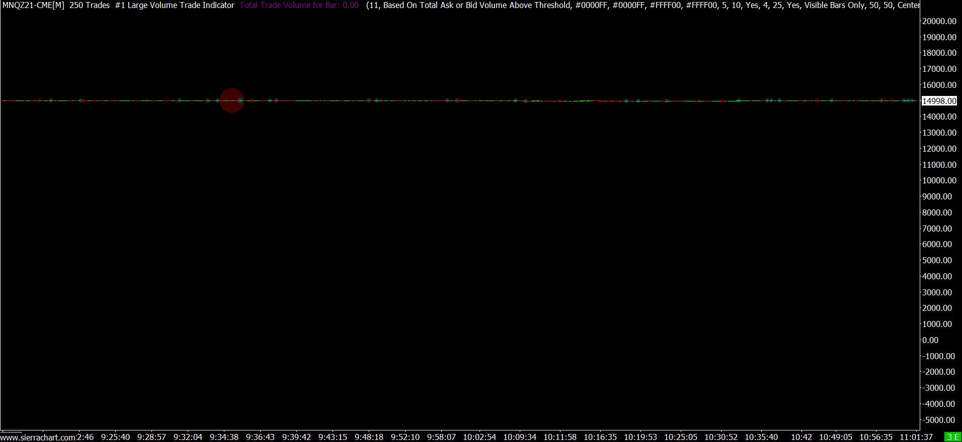

I have setting up my work template on Sierra but the large volume indicator isn't visible on my 250 tick chart. I already tested the other indicators and they work fine. What can I do to see the large volume indicator?

When we opened your chart we see the following:
http://www.sierrachart.com/image.php?Image=1633622511766.png
So you are getting the Large Volume indicators, but for some reason it is "squishing" the chart down because it thinks there is a zero value somewhere that should be displayed.
But, we do not know why this is occurring and when we put the study on ourselves and set everything the same as you had it, everything is working fine.
Therefore, please remove the Large Volume Trade Indicator from your chart and put it back on again starting from a "fresh" study (i.e. go to Analysis >> Studies and add the Large Volume Trade Indicator back on the chart).

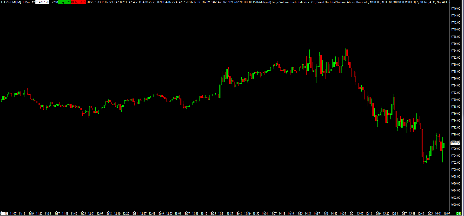

[2022-01-13 16:22:26]
User172783 - Posts: 6
The Chart is empty.
imageChart.PNG / V - Attached On 2022-01-13 16:22:10 UTC - Size: 55.33 KB - 336 views

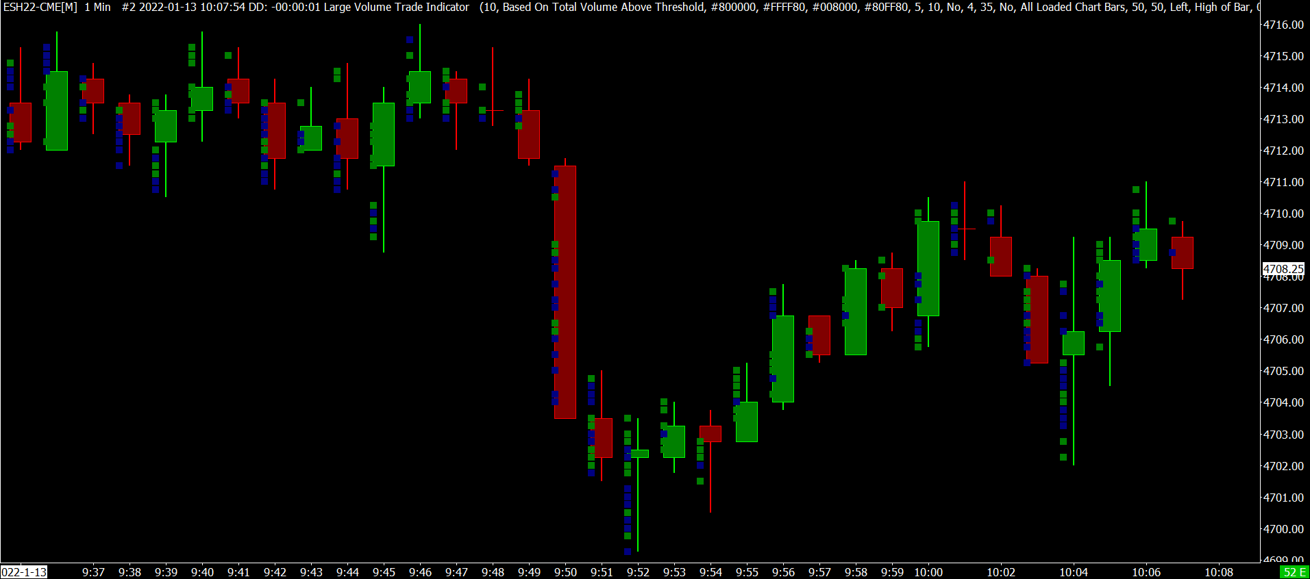

Please open a new chart for ESH22-CME and the put Large Volume Trade Indicator on it. Let us know if you get the dots showing or not.
