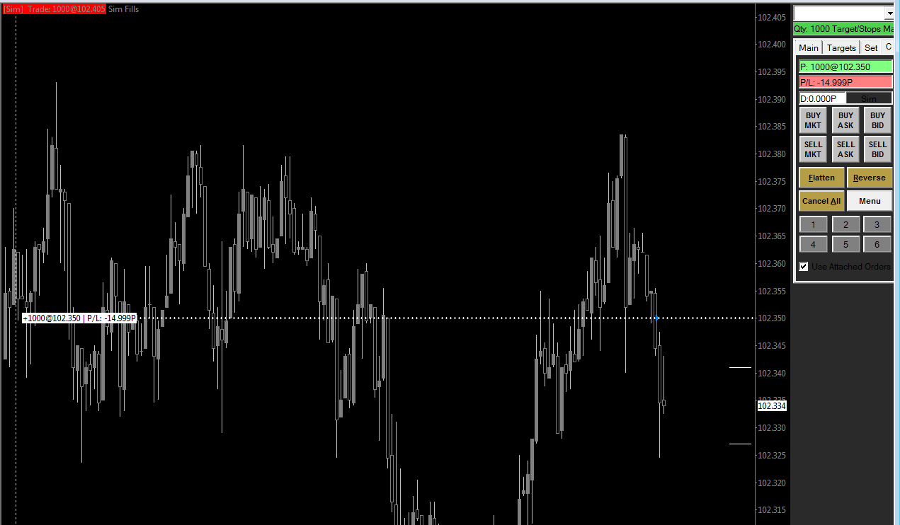

I just opened a USDJPY chart, went to SIM, and took a .01 lot trade. Notice in the P&L on the chart trade box it says the trade is negatove $14.99. That is not the correct dollar value. The correct negative for that trade should be $0.149.
It does that with every pair that crosses with the JPY. If I have a $100 win, thte P&L calculates it as a $10,000 win.
The issue this morning, I have no idea. It showed a loss, which it was, I changed the "Edit Global Symbols to get the decimal place correct, and then it showed an $1800 win. That was unique, and I am not so concerned with that. The issue is, all JPY pairs put the currency decimal poinmt in the wrong place unless I edit the Global Symbol setting.

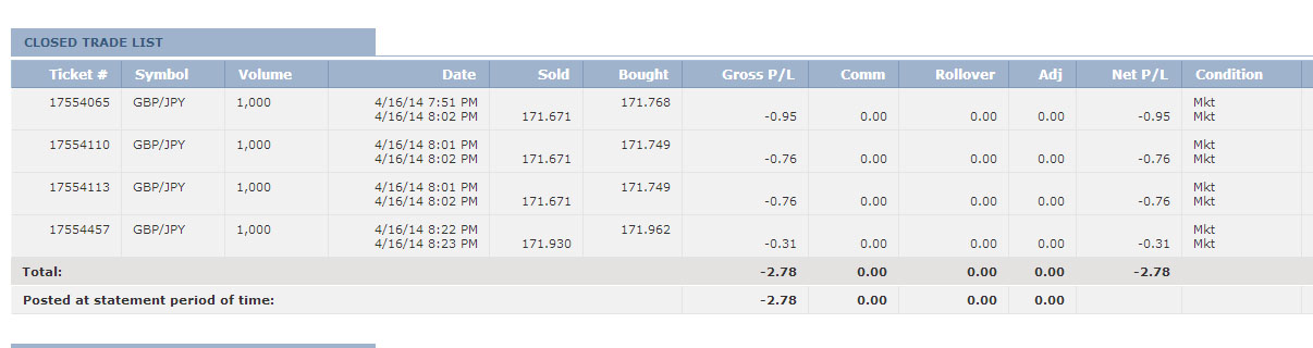

Two image files are attached. One is a screenshot of Sierra showing a GBPJPY chart and Chart Settings, with losing trade entry and exit markers. Note the $285 loss stated in both the Chart Trade window and in the indicator "Trading Profit and Loss Text".
The 2nd image is from the FXCM broker account statement for the same trades.
Date Time Of Last Edit: 2014-04-17 20:34:30
imageSC gbpjpy.jpg / V - Attached On 2014-04-17 20:29:02 UTC - Size: 283.76 KB - 687 views
imagefxcm gbpjpy.jpg / V - Attached On 2014-04-17 20:29:12 UTC - Size: 70.86 KB - 643 views
[2014-04-17 22:21:22]
Refer to step 7 here:
https://www.sierrachart.com/index.php?l=doc/helpdetails77.html
We have done some updates to it to explain why you see what you do, what the solution is and to confirm that the solution is working.
