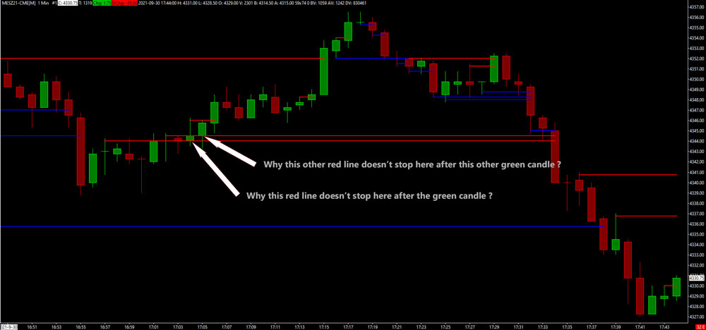

I did a study using the sc.AddLineUntilFutureIntersectionEx () acsil function and I enabled the PerformCloseCrossoverComparison. It works but not always. Attached is a screenshot where I have indicated two line that does not stop when the Close of the candle crosses the line.
It seems that this function only stops the line when it is a single candle crossing the line, the opening of the candle being on one side of the line and the closing of this candle on the other side.
Thanks for your help,
Richard
