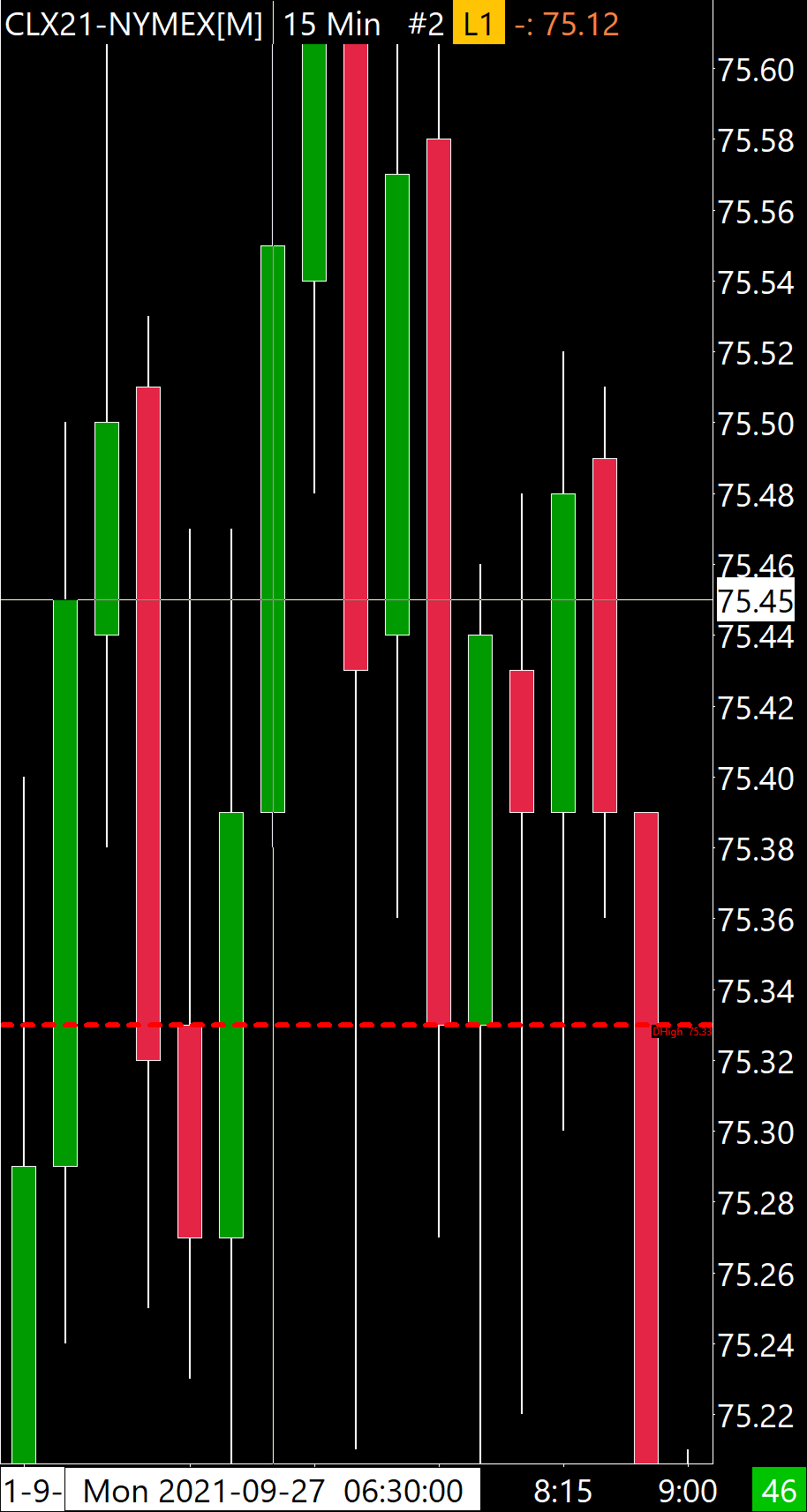

Hey there, so when I scroll my crosshair OVER a candlestick, since the candle high/low is white and crosshair is white, they turn INTO BLACK (looks like a color difference thing going on)
What is a work around so that when the crosshair is OVER the candle high/low I can still see it's high and low. Maybe a way I can set the color difference when they intercept to choose a desired color vs what seems to be a negative default color. (Coz when i changed crosshair to yellow and went over candle high it turned blue so im assuming its a negative color by default = can I custom control this color as I would like to have the crosshair AND candle highs BOTH white)

We try to blend the colors so that when the crosshair is over an item you can see what it is over. This may make for a different color altogether (such as your situation of a Yellow crosshair showing a Blue wick).
The only solution to the situation you present, where you want them both to be white, is to make the candlestick widths wider than the crosshair. That way, you will be able to see that part of it that is not covered by the crosshairs. Refer to the information here and the one two below:
