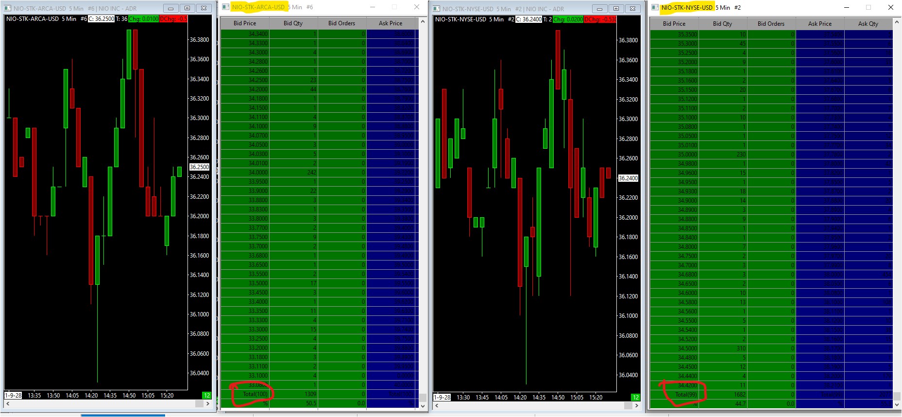

for the next charts exchange:
NIO-STK-NYSE-USD
NIO-STK-ARCA-USD
i have some questions about what i got:
1. i got 2 different level 2 for nio (one from arca and one from nyse )
*pic attached.
there is a way to see all the data in one market depth window ?
i tried to open chart which include all but i didnt get there market depth
(i tried: NIO-STK-SMART/NYSE-USD and it didnt worked.... i allso tryied as i see in your NIO-STK-SMART[NYSE-USD (when i done it, it opend again NIO-STK-SMART/NYSE-USD (with out the "[" symbol)
2. i get only 100 rows for level 2
* u can see allso in the pic i attached
there is a way to see all the data of market depth (more then 100 rows) ? ( in interactive broker program i see much much more )
3. there is a way to put another column in market depth window which show me the exchange name ?
many thanks.

User504778 - Posts: 22
Glad it worked for you.
1. No. I believe the symbol suffix "-STK-NYSE" or "-STK-ARCA" has designated which exchange you pull Level 2 data from. So I use NASDAQ TotalView/OpenView only, because I believe it has the most volume among all exchanges.
2. 100 lines is the limit of SC. The only possible way would be to use ASCIL to read the Level 2 data directly. I can test it when I get a chance, but 100 lines would be an overkill for me because the price would be so off that they're not relevant after 50 levels or so.
3. Not easily. The only solution would be to open one window for "NIO-STK-NYSE" and another for "NIO-STK-ARCA", then write an ASCIL program to pull the data from each window, add them up, then display the sum. It's cumbersome but doable.

[2021-09-28 18:20:47]
My understanding is that each exchange has its own order book, for example NASDAQ, NYSE, ARCA, which are separate from each other. In IB's TWS, you will be able to add up all the orders from the exchanges that you subscribe to, but Sierra Chart can only get Level 2 data from a specific exchange, which is a subset of what you get in TWS. I chose NASDAQ because I don't want to pay for multiple Level 2 data and I assume NASDAQ volume is indicative of the total volume in the market.
SMART is an automatic route that IB uses for order processing. However, you cannot use "NIO-STK-SMART" to get level 2 data according to SC's documentation, you have to choose between "NIO-STK-NYSE", "NIO-STK-ARCA" or "NIO-STK-ISLAND" (which is NASDAQ), etc. depending on where you want to get the Level 2 data from.
