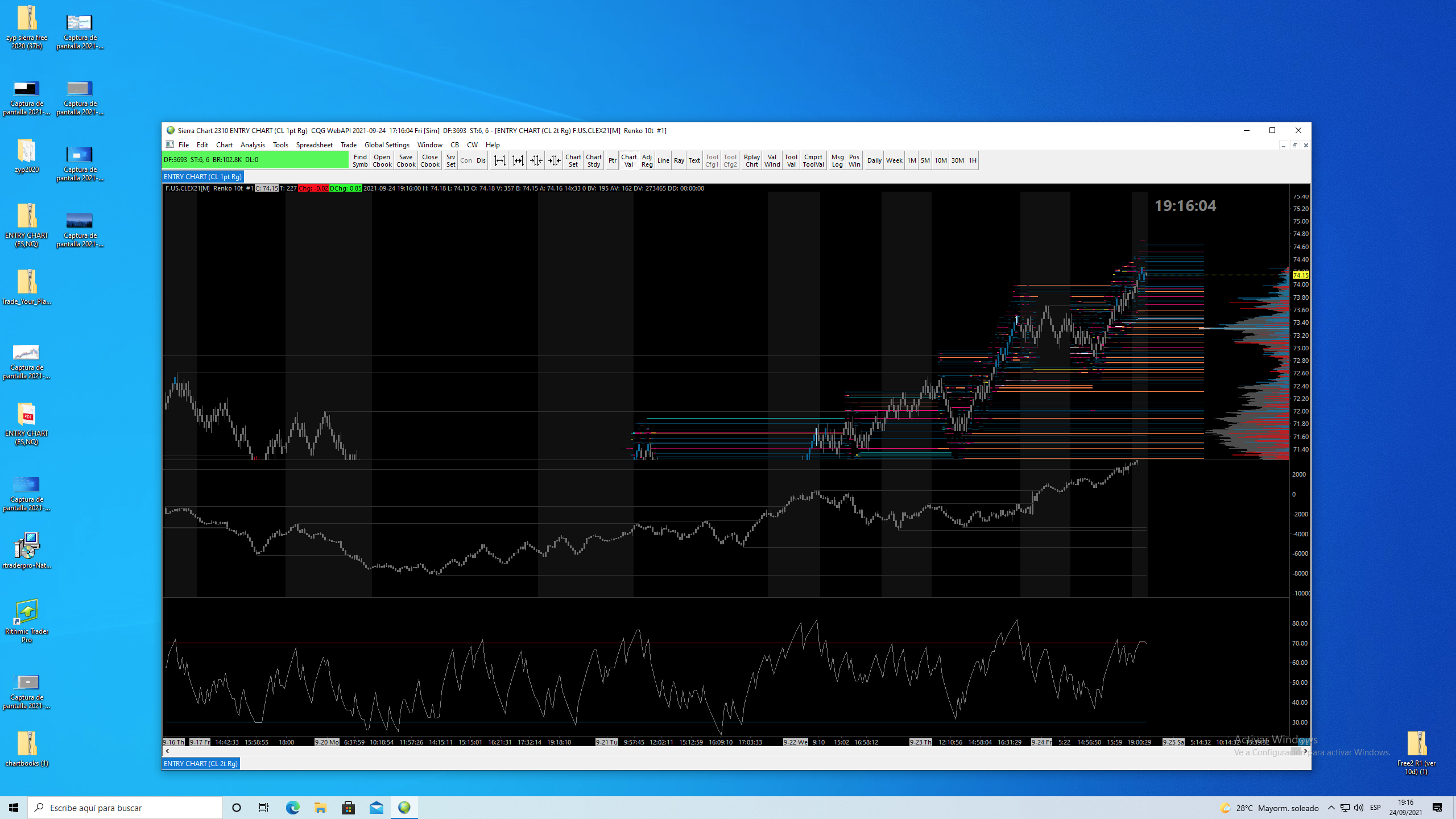

well i opened an new chart and Reset NGX.
But when i try to load my cht my Sierra just shut down.( screenshot)
The same cht is working with all the other assets without any problem (screenhot)
Yesterday i made the rollover and i didn t had any issue , but this morning all started.
I attach the cht too

[2021-09-24 18:51:38]
The issue must be caused by one or more of the studies on the chart. Remove all of the studies from the chart and see if you have a problem.
What you are experiencing is a long calculation time issue.
Not an abnormal shutdown.

[2021-09-26 16:33:29]
It looks like there is some bad data in the file. Open that chart and make sure it is the active one, and then select Edit >> Delete All Data and Download. This will re-download all the data from our servers and should fix the issue.
You just need to perform this step one time for one of the charts with this symbol.
