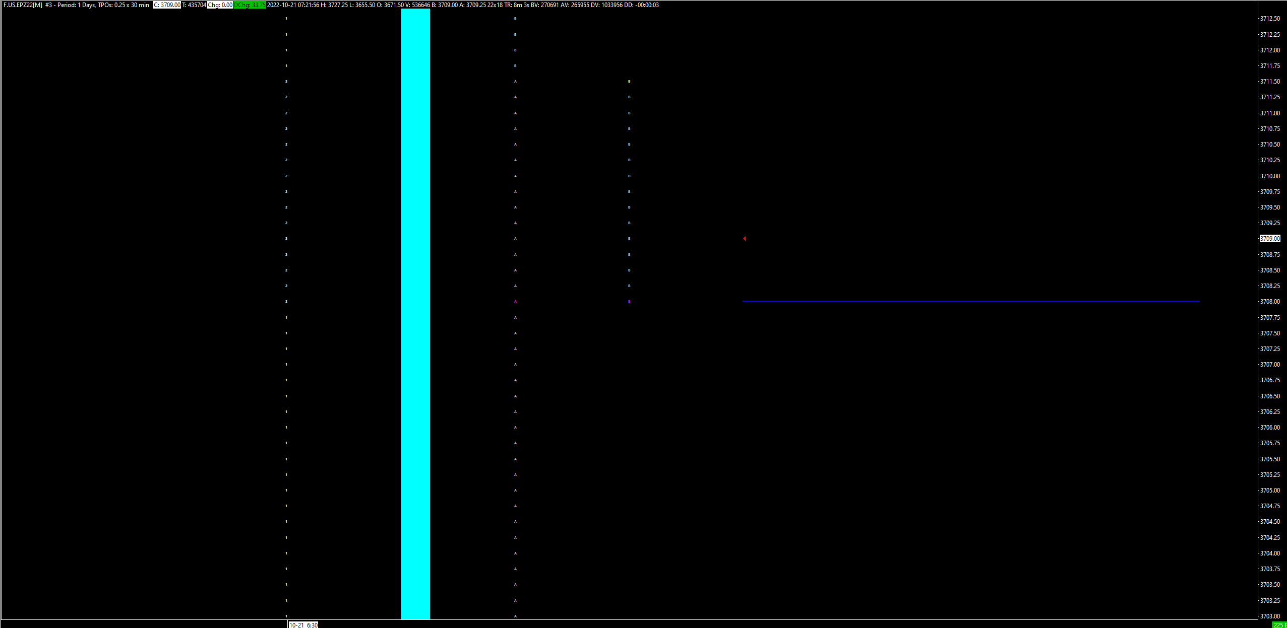

hello, I have a big problem with the TPO graph, I can not get an adjustment that allows me to read the letters, they are very small and the graph is not usable. Thank you for helping me please I have searched a lot but I can not find, I do not understand, I have put two screenshots for you to understand. thank you

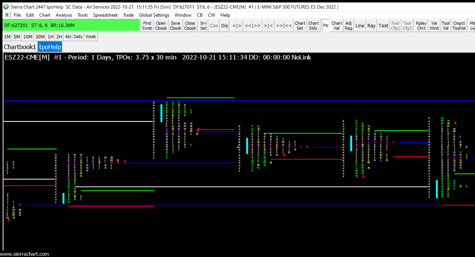

Yes, I attached two screenshots. One is the zoomed out view with Letters and second attachment is the TPO zoomed in to where I can read the letters. Not sure what I did wrong. I have followed a couple youtube tutorials on setting it up but it is not working correctly.

You need to adjust the Letter/Block Price Increment in Ticks to a larger value. This will consolidate multiple prices into a single block making it easier to read when you are zoomed out like you want to be. Keep adjusting the number up until you get what you want. Refer to the following:

I changed it from 1 to 4 and still looks the same. The letters are very small and spaced out and look nothing how other SC users charts look.

Make sure the Letter/Font Size is set to 0. Or, if it is already 0, then try 8 or 10 and adjust from there. Refer to the following:

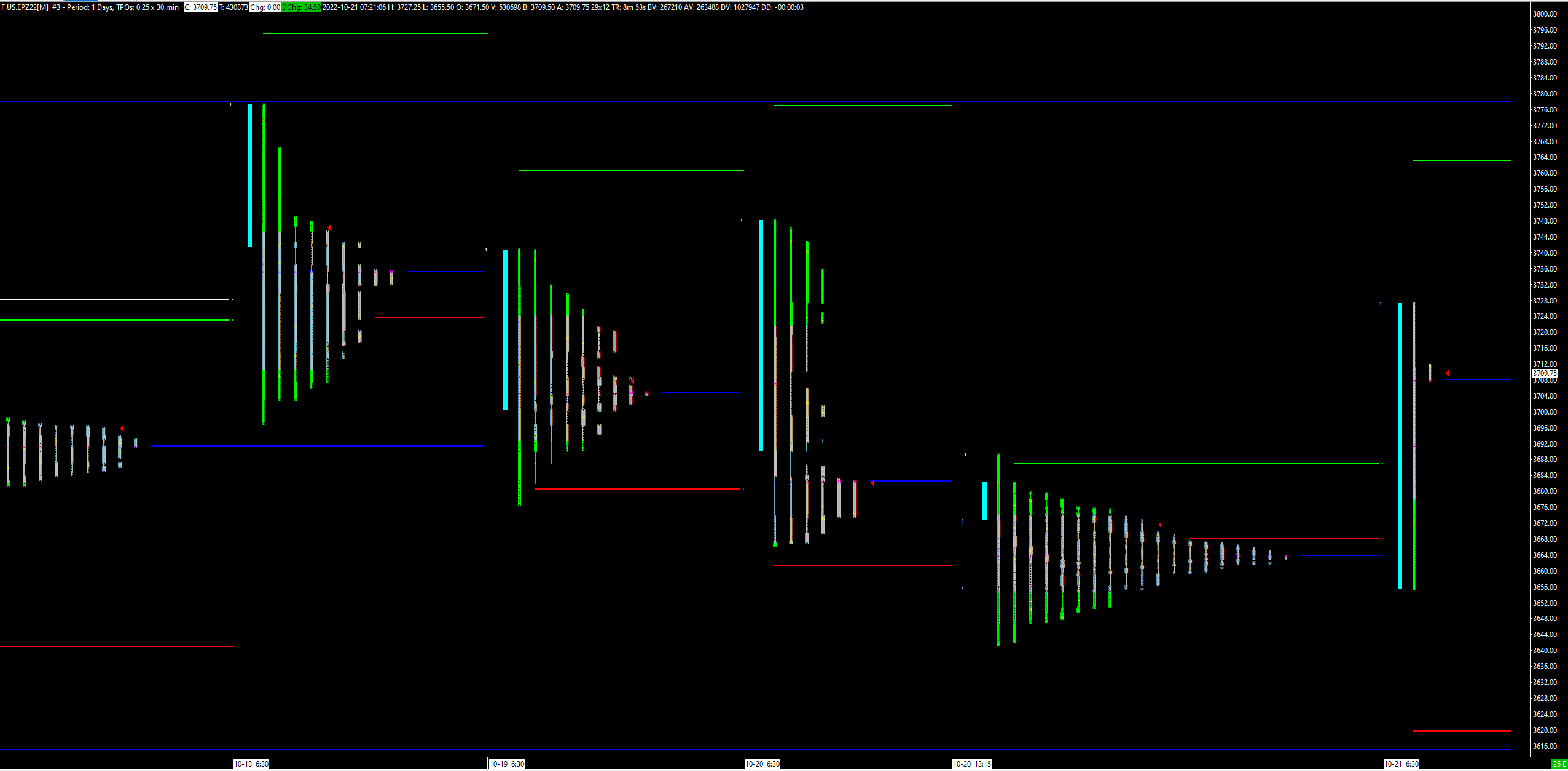

The image at the link below is what we can make it look like:
https://www.sierrachart.com/image.php?Image=1666383096385.png
Start by using the Page Down button on your keyboard to be able to view multiple TPO days at one time.
Then we set the following:
- Letter/block Price Increment in Ticks: 15
- Letter Font Size: 0
