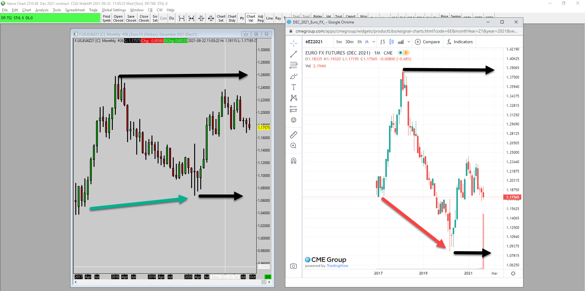

Hi. I've tried to trouble shoot this myself, but no luck.
The CQG data on your charts for the monthly 6E futures contract is so inaccurate that it's completely useless. I've compared it in the attached screenshot with the monthly chart provided directly from the CME website.
Please notice that not only is the high and low on Sierra Chart completely wrong, but Sierra Chart shows a higher low formed beginning of 2020 whereas on the CME chart it was most definitely a much lower low.

We do not provide technical support, for data from CQG. No support at all.
Also, the Sierra Chart Continuous Futures Contract functionality is not supported with CQG data.
You need to change your Service Package to 10 to use Sierra Chart provided historical Daily data. Follow the instructions below.
To change your Sierra Chart Service Package, select "Help >> Account Control Panel" on the Sierra Chart program menu. On the displayed webpage, click on the "Set Service Package for Renewal" link.
Or go to this page:
https://www.sierrachart.com/UserControlPanel.php?page=ServicesActivation
You will need to login if you are not currently logged in.
In the "Available Services >> Choose Usage Time Service Package" frame, select the Service Package that you want to set your account to. Press the "Set" button.
The remaining service usage time on your account will be adjusted based upon the cost of the package you are changing to. If the new package is a higher-priced package, then the usage time will be reduced due to the higher price.
There is no charge for changing your Sierra Chart service package. Only your Sierra Chart account usage time ending date is adjusted.
Once that is done, Re-download all the data in the chart by going to the chart and selecting "Edit >> Delete All Data and Download". You just need to do this once per symbol and not for each chart.
