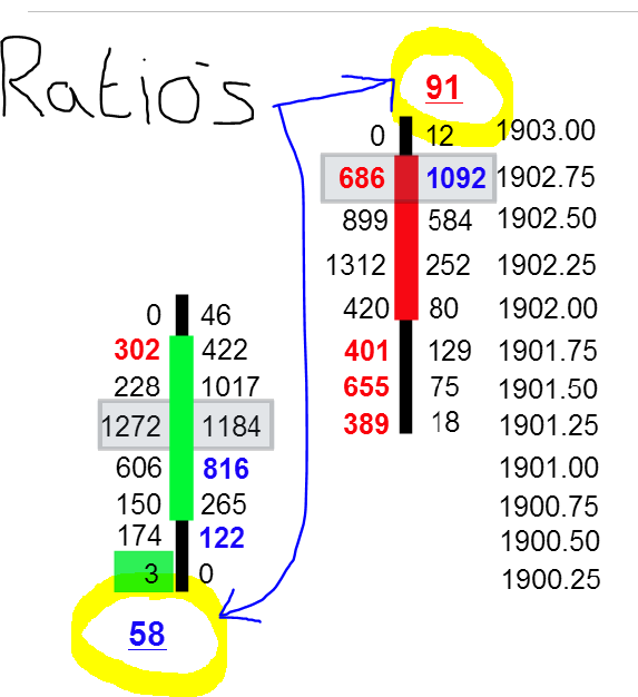

I use the Numbers Bars Study - as my Footprint - on a 10 tick range. One of things I like to look are the ratio's of the lowest 2 Bid values (for an up candle) and highest 2 Offer values (for a down candle). Is it possible to automate this calculation and display it as a value below / above each bar? (See attached as an example).

You would have to use the ACSIL interface to do this, as the Bid and Ask data per price is not readily available through the standard interface.
Refer to the following if this is something you would want to take on yourself:
Advanced Custom Study Interface and Language (ACSIL): Introduction
Or refer to the following list of programmers that you could contact:
List of Third Party Sierra Chart Study and System Programmers
It's also possible that someone may offer you their services from your post.

"I use the Numbers Bars Study - as my Footprint - on a 10 tick range. One of things I like to look are the ratio's of the lowest 2 Bid values (for an up candle) and highest 2 Offer values (for a down candle). Is it possible to automate this calculation and display it as a value below / above each bar? (See attached as an example)."
You can download study for it....
Study: Numbers Bars: SG Combined AVAP/BVAP
from the library Free1 (2019)
contact link:
or check the AVAP, BVAP options in the Sierra documentation
