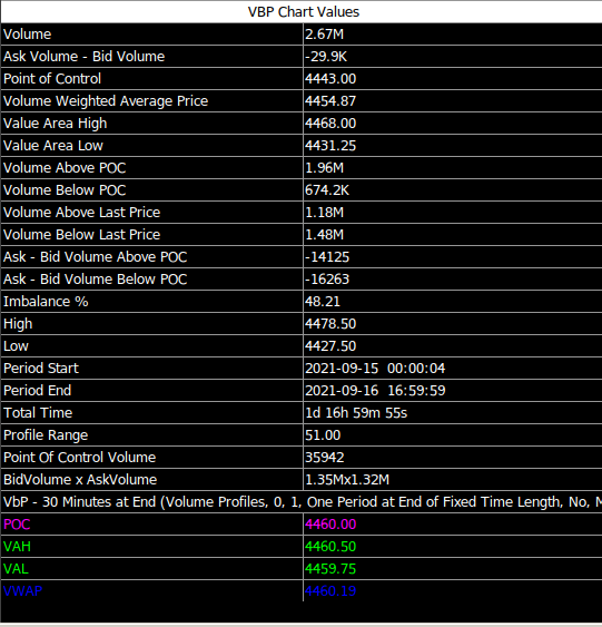

What is the best way to get access to the Volume by Price (not volume at price) for the VpB study? The information I'm looking for is from the Chart values Window and the image is attached. Ideally, it would be available similar to how Numbers bars calculated values performs.
I did look through study ACSIL but only found Volume at price which is bar by bar.
imageScreenshot from 2021-09-16 17-38-07.png / V - Attached On 2021-09-16 21:48:30 UTC - Size: 44.79 KB - 403 views

Refer to the following:
Volume By Price Study: Accessing Volume by Price Calculated Values
[2021-09-17 01:33:08]
This information can be accessed through ACSIL. Refer to this function:
ACSIL Interface Members - Functions: sc.GetStudyProfileInformation
Date Time Of Last Edit: 2021-09-17 01:33:21
