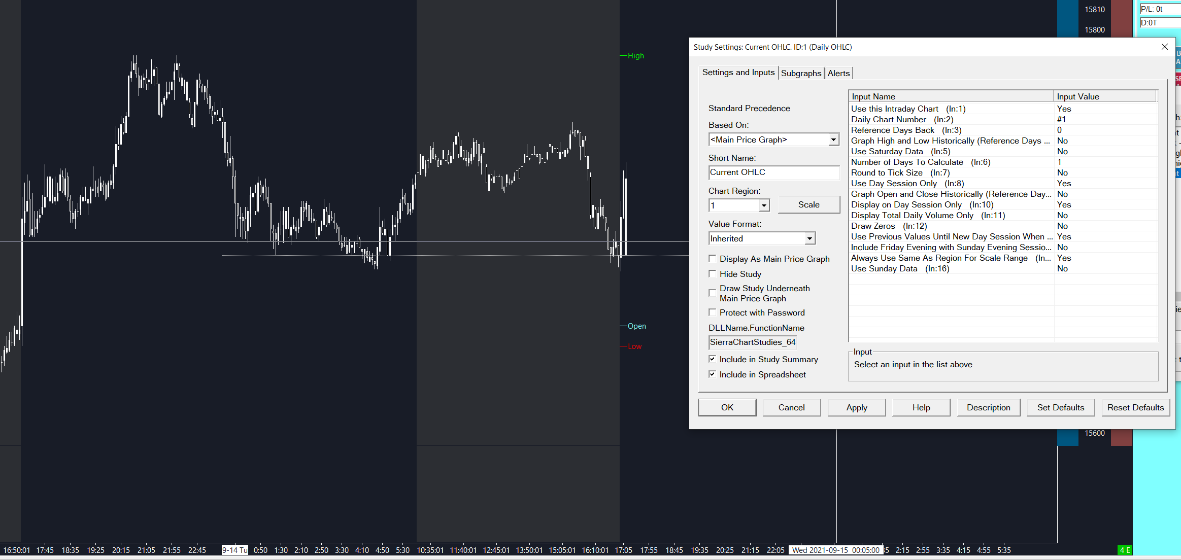

From the screenshots attached, you can see that the Daily OHLC indicator should be plotting todays values but appears to be plotting yesterdays.
If I change "Use Day Session Only" to no, then it references the beginning of the evening session instead.
The Reference Days Back setting when referencing 0 appears to be broken.
imageChart Settings.PNG / V - Attached On 2021-09-15 00:23:59 UTC - Size: 136.7 KB - 355 views
imageStudy.PNG / V - Attached On 2021-09-15 00:24:05 UTC - Size: 127.48 KB - 342 views

We are not seeing anything in particular that would be causing this, but there has to be something in the settings that is creating this situation, as this study has been around for a long time.
Get us a copy of that chart so we can take a look at it by following these instructions:
Also, let us know what your Global Time Zone is set to if the Chart is set to use the Global Time Zone.

We are still working on this. We do see why it is occurring, but we have to spend some more time on updating the code.
[2021-09-26 15:26:03]
There are some changes that we have made that will be in the next Pre-Release (v 2314).
But, we are not sure this will completely resolve your issue. In the end, the trouble is that the system expects your Session Times to be in the same time zone as the exchange itself. When it is set very differently (as you have it currently) the system has a hard time determining the day and evening sessions. Our recommendation is to change your chart time zone to match the exchange time zone. Refer to the following:

Sierra_Chart Engineering - Posts: 25390
We are still considering a solution for this, but the main issue is that chart really needs to be set to the time zone of the exchange which is going to be Brussels time.
You need to change the time zone and then adjust the Session Times accordingly. Refer to:
Time Zone Setting: Using Different Time Zone in Individual Charts
The day session start and end times should not be reversed and be within the same day.
Date Time Of Last Edit: 2021-09-29 18:01:41

SoraTrading - Posts: 19
2314 didn't fix the issue.
I've changed all the charts to the exchange time zone which works.
