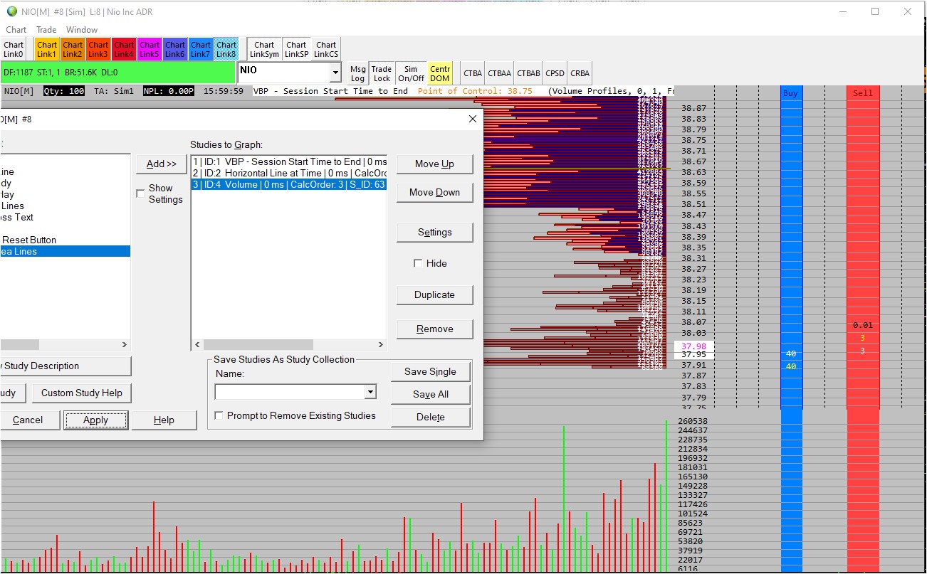

hello,
how can i see all volume area in the actual window size?
in the attach pic, i dont see all the volume, only when i change to window size i see more volume bar data.

Are you referring to the Volume study? What exactly do you mean by this:
In any case, refer to:
Chart Scale and Scale Adjusting: Chart Bars or Studies Not Completely within View, Not Displayed, or Cut Off. Reset Scales.

yes, i mean to the volume study. i want to see volume on the vp at dom(as like in pic)
-if u have other solution to see volume with other study, i will happily to hear about it.
- and still the volume is "cut" as i describe above...
another question:
there is an option to add chart and volume to the dom chart (as i added the volume study )?
[2021-09-12 22:00:11]
If you are referring to the Volume by Price study being "cut off" in that you are not seeing all of it from top to bottom, then that is just a scaling issue. You would have to adjust your scale in order to see the entire profile. Refer to the following:
Chart Scale and Scale Adjusting: Interactive Scale Range - Expand/Compress Scale
If you are referring to the Volume study not showing far enough back in time, then that is going to be a limitation of the Trading DOM, as it does not have the same concept of bars as other charts do. To see more Volume bar information, you would really need to just use a standard Chart with the Chart DOM on it.
