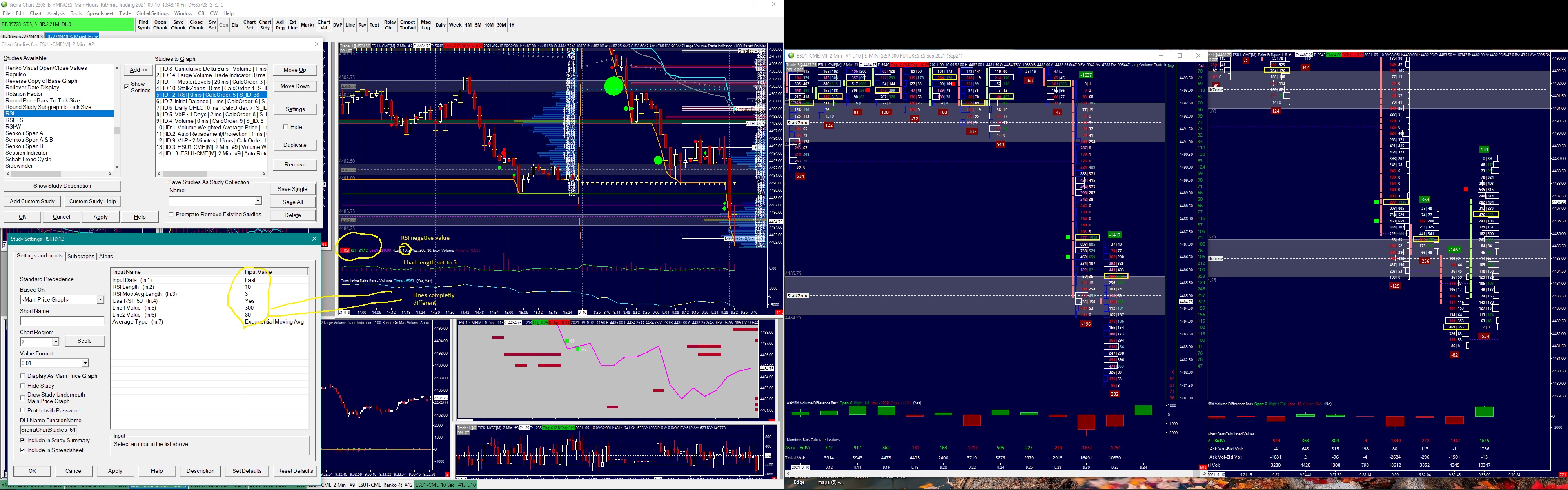

I have updated SC today and RSI indicator calculations are ... wrong.
RSI is oscilator 0-100 now showing -35, -300 etc ... all the setups (lines at 80 - 20) are wrong (lines at 300 - 80)
Can you please look into it.
Kind regards
r.
[2021-09-10 14:56:29]
We pulled up the "RSI" indicator and it is showing the correct data for us. Are you using a different RSI indicator (RSI-W or RSI-TS)?
Also, can you please include a screenshot so we can see exactly what you are seeing.
[2021-09-10 15:56:00]
Kefir - Posts: 34
I hope it gets uploaded.
This RSI reset occurred in all charts and all chartbooks ... I just checked it.
The average was also displayed although I had it hidden in my charts before.
Line values were set in all chart to Line1 3, Line2 80, Length 10, AVg Length 3
imageRSI reset.jpg / V - Attached On 2021-09-10 15:51:50 UTC - Size: 1.24 MB - 316 views

There was an update to the RSI study which added the following Input Use RSI -50, which allows the RSI to be offset by 50 points, to allow it to oscillate around 0 instead of 50. Apparently when this was added, it was not done in a way that kept the settings when you had the RSI on previously.
Therefore, you will need to setup your RSI studies to set the Input Use RSI -50 to No and change your line values.
