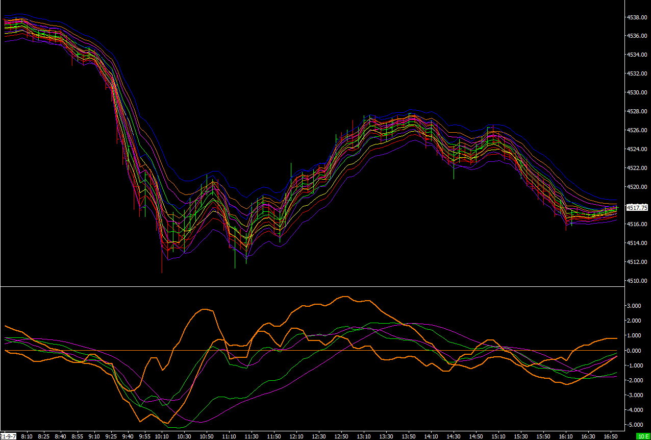

Out of curiousity, I just created a 5 minute chart in about 3 minutes which accomplishes what I understood you as wanting to do.
**It's important to create a new chart first (Step 1 & 3) to do this, especially if your chart already has other kinds of indicators on it as well. Start fresh. Then you'll be able to easily figure out how to do it on an existing chart, amidst other studies that are listed in the settings.**
Here's the steps:
1) Create your 2 minute chart.
2) Add your 3 studies (Double Exp. Moving Avg., Fib Bands, MACD Leader).
3) Duplicate this chart.
4) Change it to a 5 minute chart.
5) Add 3 Study/Price Overlay studies.
6) Move them up/down in the settings, put them numerical order (optional)
7) In the first S/P Overlay, select the Double Exp. Avg in the top input "Study To Overlay".
8) Before you close the settings, select "Chart Region 1" for this.
9) Repeat step 7 & 8 for the Fib. Bands in the next S/P Overlay.
10) Repeat step 7 for the MACD Leader in the 3rd S/P Overlay; BUT- change the "Chart Region" to #2.
11) Add region dividing line, or otherwise clean up the chart values, etc. to your liking.
Here is an image, using the default settings of these studies:
http://www.sierrachart.com/image.php?Image=1631051535548.png
Date Time Of Last Edit: 2021-09-07 21:55:25
