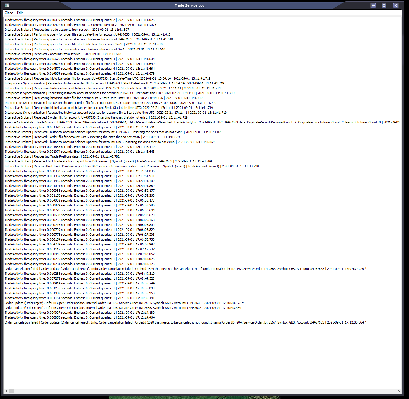

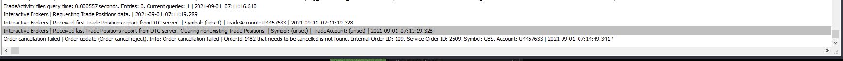

GravisHTG - Posts: 321
Ok , I check and I found an error that only happen to GBS on any instance. ( i got 12 )
Just realize I have an error code and I tought it was it , but I try to redownload or to trade on another Symblo and it work.
I paste the message log in a text file and did a print of my Trade service.
So basicly , I try to Trade with my keyboard shortcut on GBS - ( all limit shortcut ) and the trade is just not going to the IB platform.
I see the buy line or sell line on my SC platform , but I dont see anything in my activity monitor of IB and I cannot edit the Buy/Sell line from SC. And when I cancel the order , I dont have have the Voice clue from IB. ( order CANCEL )
If you need anything else , Just ask me ! ( I will add everything you ask or need tomorrow ! )
And its the first time I am aware of this error that happen in the message log ( might have been there for a while , I dont look at that often )

[2021-09-03 03:30:34]
Sierra_Chart Engineering - Posts: 25428
We cannot help with Interactive Brokers trading issues. There are more than enough warnings given here:
Interactive Brokers Trading Service
We definitely cannot provide any help with this at all.
This has no relevancy to the issue and also positions are provided by Interactive Brokers. Missing order fills would only impact the order fill calculated position which is not relevant here and would be unlikely to be used and not necessary:
Our initial impression was that you had a missing fill in Sierra Chart, in which case, when you place another order, Sierra Chart is seeing it as an offset to a previous position, whereas it is an initial order in IB.
These errors are very unusual and not sure why they are occurring repetitively:
File compression not supported on file system. D:\SierraChart - NEW VERSION 16-03\SierraChartInstance_10\Data\AAPL.scid. Windows error code 1: Incorrect function. | 2021-09-01 17:08:43.836
Are you using the standard Windows operating system?
Date Time Of Last Edit: 2021-09-03 03:33:41
