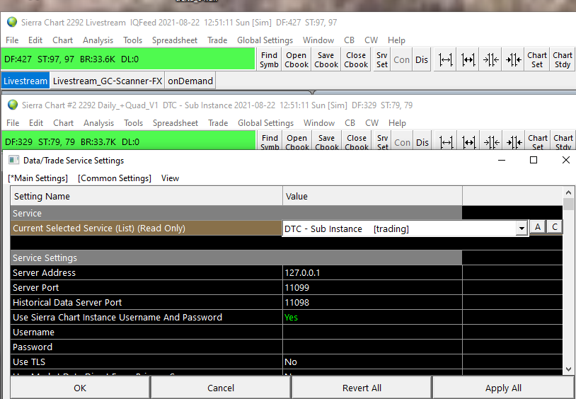

i love the sierra charts data feed for stocks, unfort there is no option chain, using IQfeed, my main instance connects no problem, but i cannot launch a secondary instance. is this a IQfeed issue ? i can launch the instance no problem but cannot connect to IQfeed data with it.

so now, after full reset,
i have both connected but the sub instance still says DTC-Subinstance as per screenshot
i cannot move to IQfeed for 2nd instance, or am i connected already? not sre what DTC sub instance means
imageCapture7.PNG / V - Attached On 2021-08-22 16:53:02 UTC - Size: 65.27 KB - 367 views
[2021-08-23 04:40:33]
If you want two direct connections to IQ Feed, install another installation of Sierra Chart as explained here:
Using Multiple Data and Trading Services at the Same Time
What you are currently doing is a sub instance and that accesses data from the main instance which in this case is accessing data from IQ Feed.
