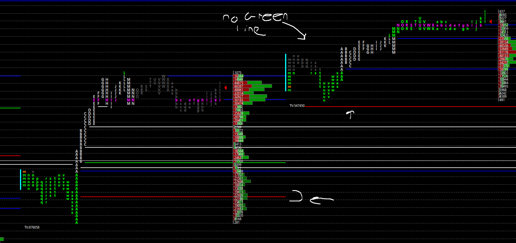

Bhupinderjhajj - Posts: 30
Hello John,
The initial balance range is just the first hour of trading range. But the red-line and the green line (redline in particular) are below the entire days range. How could it be the Initial balance's range? also some days I don't even get the green line. If it was the IB range, I should see both lines every day right?
I've attached a photo,
Thank-you
Bhupinder
imageredline and green line.PNG / V - Attached On 2021-08-26 05:22:06 UTC - Size: 68.7 KB - 441 views
[2021-08-26 09:19:48]
The study supports initial balance extensions.
Refer to the documentation:
Time Price Opportunity (TPO) Profile Charts
